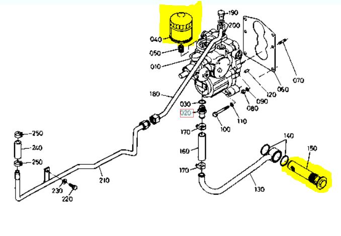

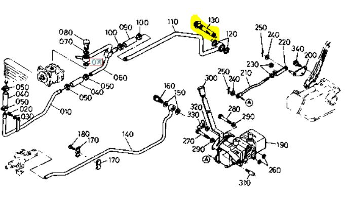

There are two hydraulic screens / filters for the system and one spin on filter, most people only ever clean or change the first screen and the spin on filter, but the bulk of the work is actually done by the screen filter.
If you haven't checked or replaced the HST screen, or spin, drain and do all three with new UDT compatible fluid.
Hydraulic filter
HST filters

I think you might be right re the filters. The fuel is fine and the engine runs really well and the PTO doesn’t slow, but I change the transmission fluid a year ago and only changed the spin on filter ( didn’t realise there were other ones). I’d guess I’m gonna have to drain and check these other ones. Mine doesn’t get a lot of work so changing fluids doesn’t happen that often but if the filter hasn’t been changed or cleaned for five years it could well be a bit ....better!

Thank you ! Thank you! Drained the transmission down and got the strainers off... they were dirty. Filled up and everything’s good again. Cost zero... so very happy. Can’t thank you enough!
