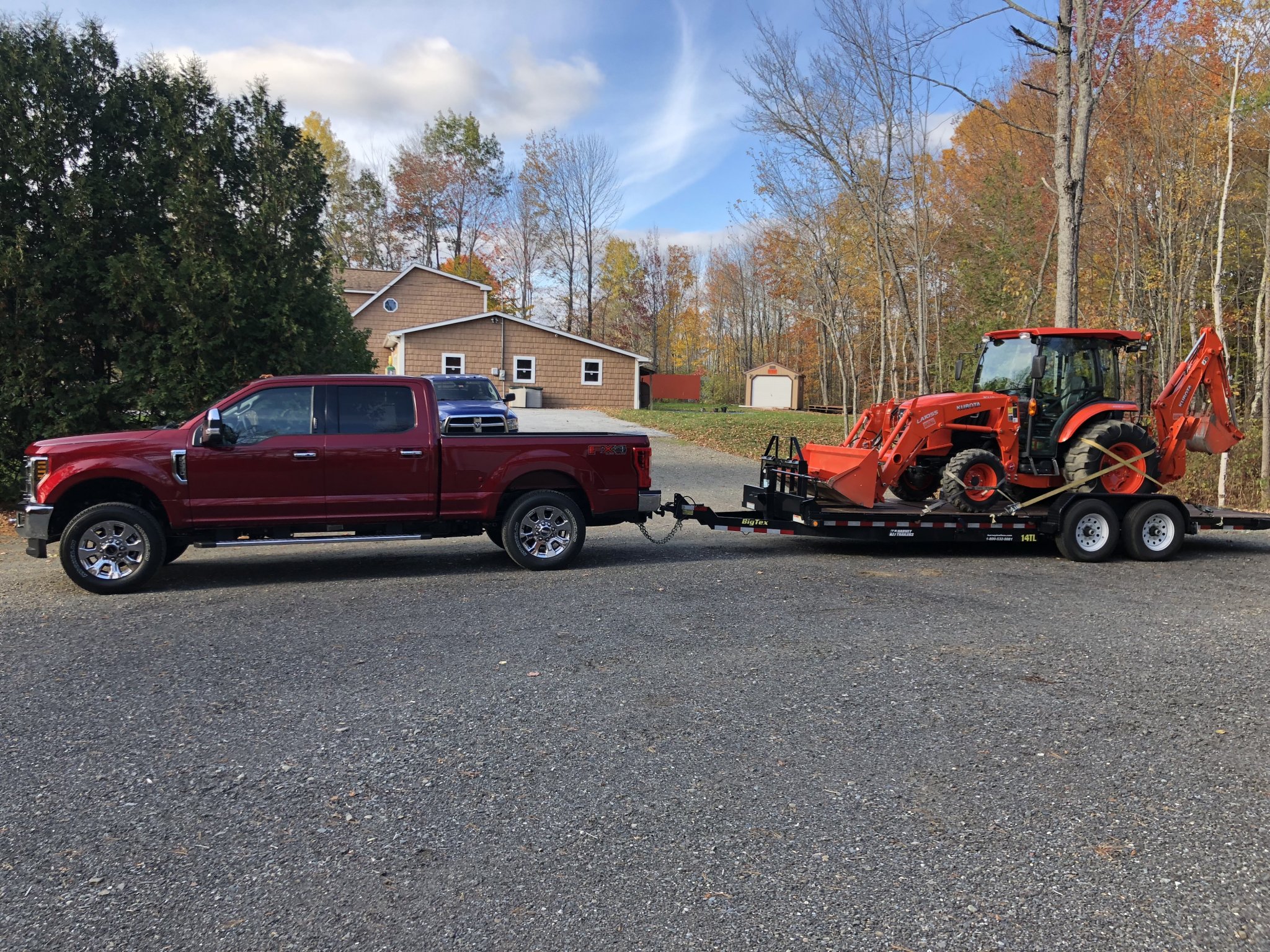

I doubt it, I have a Gr L6060 and with a 6" bush hog on the back with the loader, I have to run the tractor all the way up on my 22" trailer (14K). I notice my 2019, F250 will squat some when I do that. I think you will notice a bit of sway from the 4 ply tires on the 1/2 ton vs the stiffer 10 ply on the 3/4 ton also.

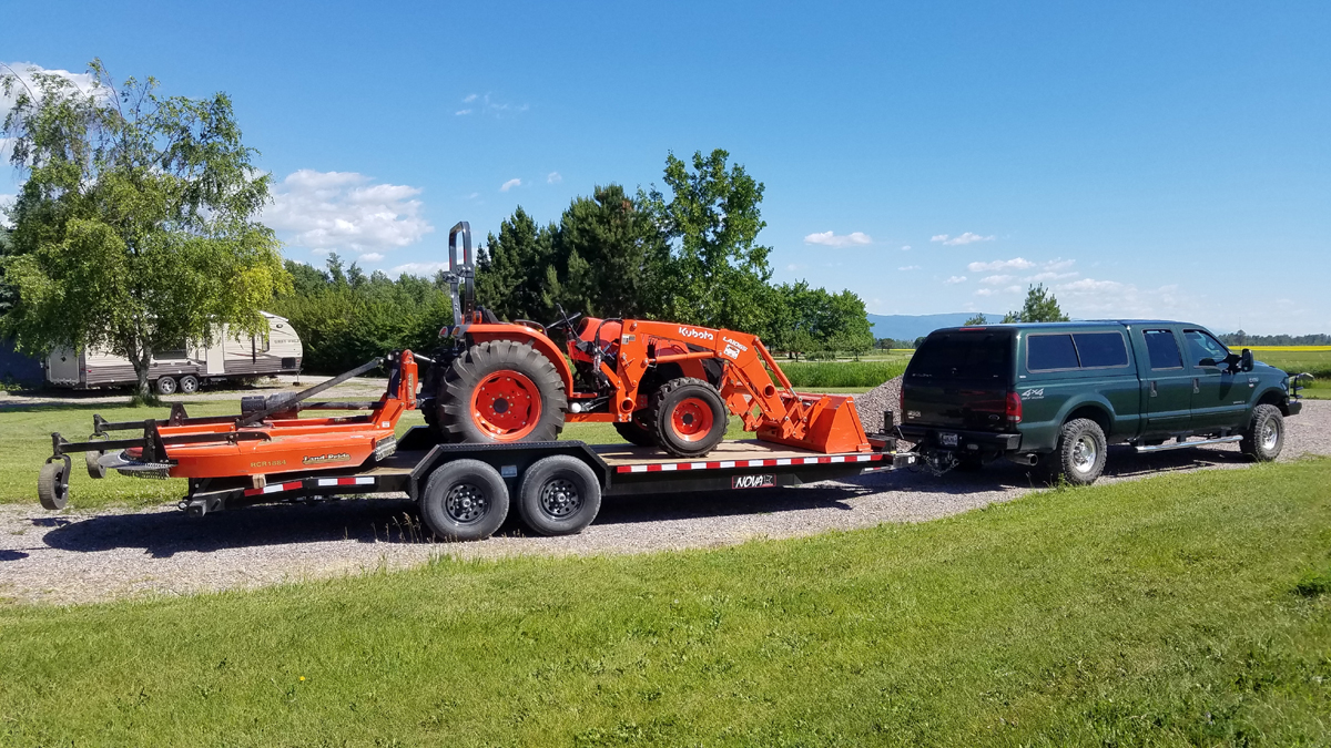

Not sure if this is helpful but I have an MX6000 and have trailered it with the Land Pride RCR1884 attached. I have a MidSota 22ft trailer. I'd like to try backing the tractor and cutter on next year and figuring out a way to rest the loader on the ramps or make up something for the bucket to rest on. The other possibility is to remove the FEL when I go to a friend's place to cut his fields.
I ended up buying and installing a Curt load leveling kit for my truck/trailer.
