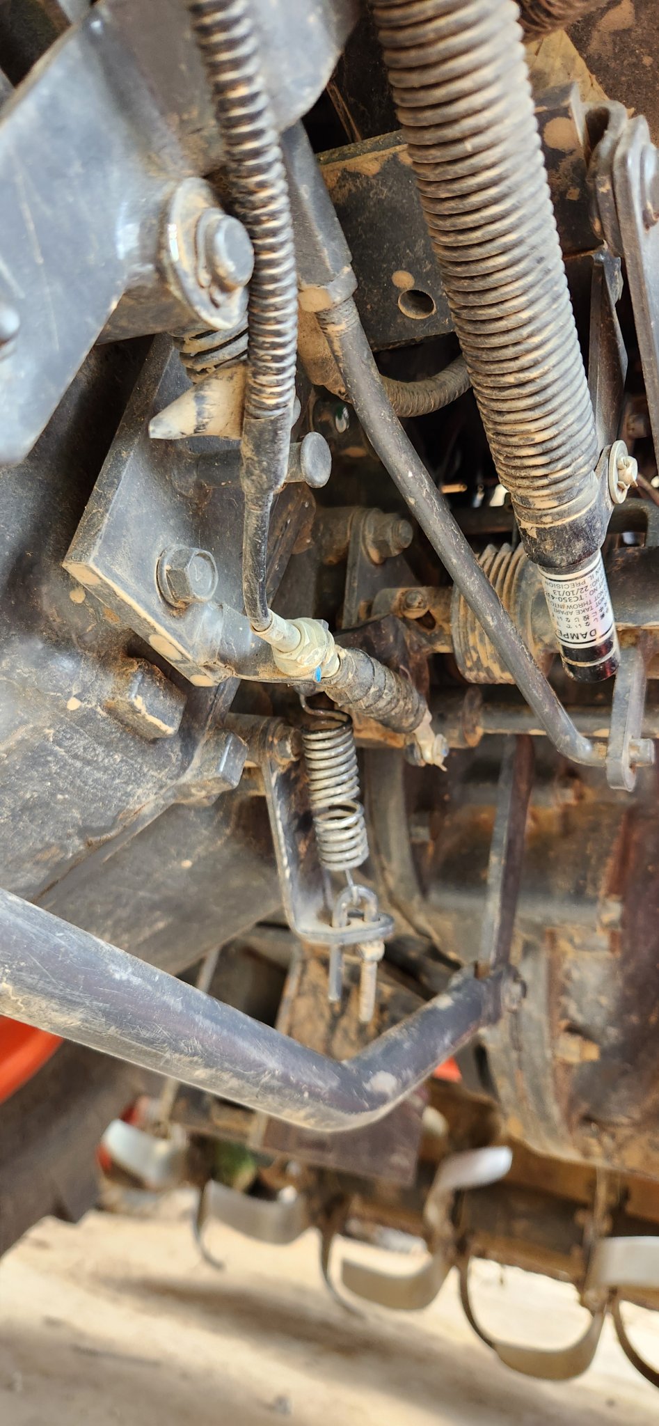

My mx6000 cruise lever will not hold the pedal at speed. It just goes back to nothing. It seems like the lever has lost tension. I glanced under but it was 97 degrees out and I really didnt see how to tighten it.
Anyone else ever have this issue? Its still under warranty but I hate to haul it in for something simple. Thanks.

Thanks! It certainly feels like something came loose.i will check and let you know. If anyone has a picture of that area they could share i would be appreciative.

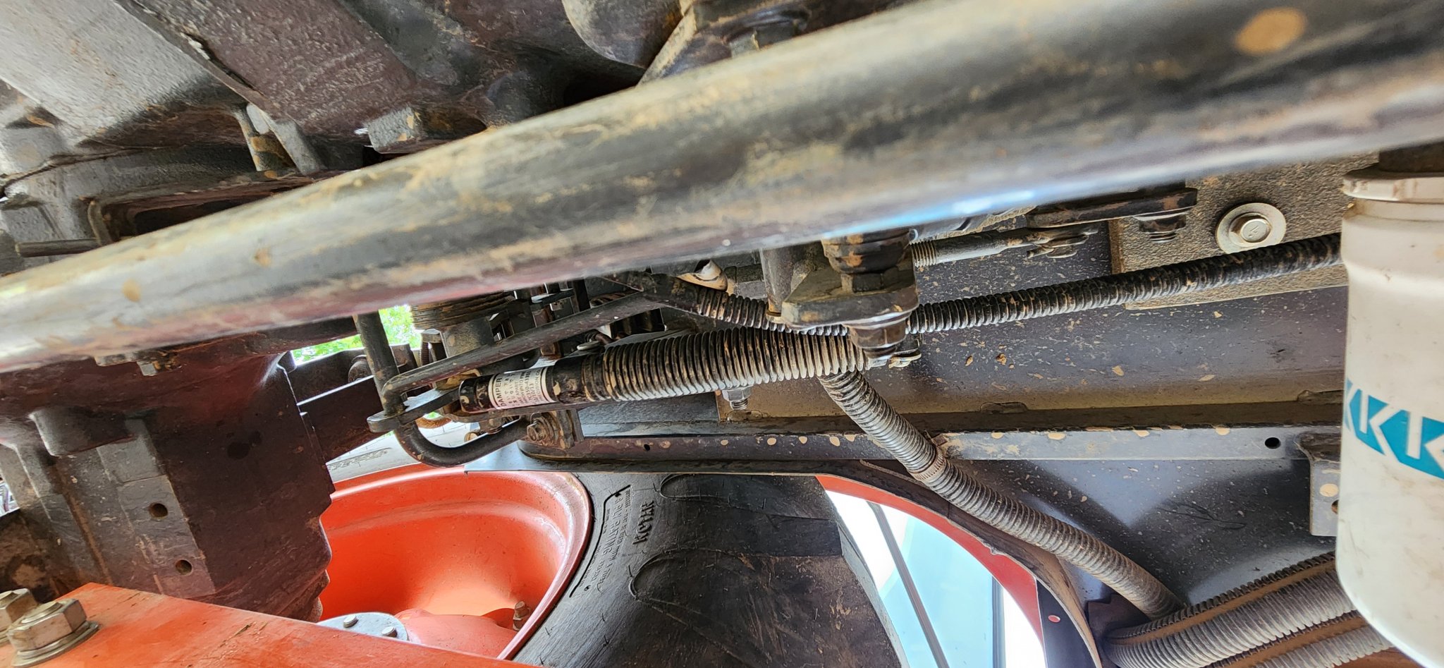

Looked at it today. Spring is in place. Looks a the damper lost its charge. Its the part with the silver label in my pic.

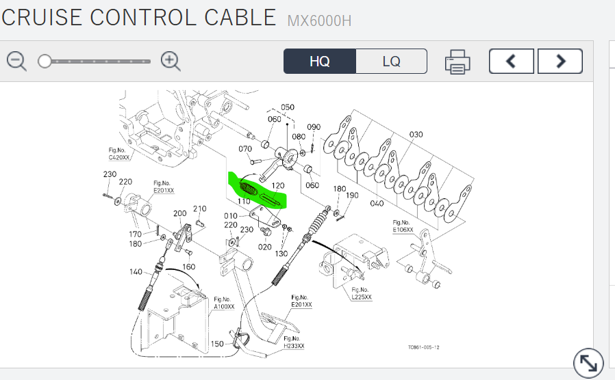

Ironically, I cant seem to find that part on any diagrams.
Hard to tell from picture, pretty sure that is the HST damper. Cruise linkage is sorta above and behind.
I was thinking the cruise would be tightened the same as 3 point. Double nuts and some nylon washers. I can seem to find anything that looks like that on the parts breakdown. Keep us posted, mine is loose too.

Its still under warranty, so I am going to call them tomorrow and see. From the diagrams it looks like their is a cruise control wire that I dont recall seeing on mine. I wonder if they updated it with the damper? I didnt spend much time looking at it, but I am pretty certain the cruise lever worked that damper. I will post up what I find out. The cruise lever works, it just wont hold the position.
