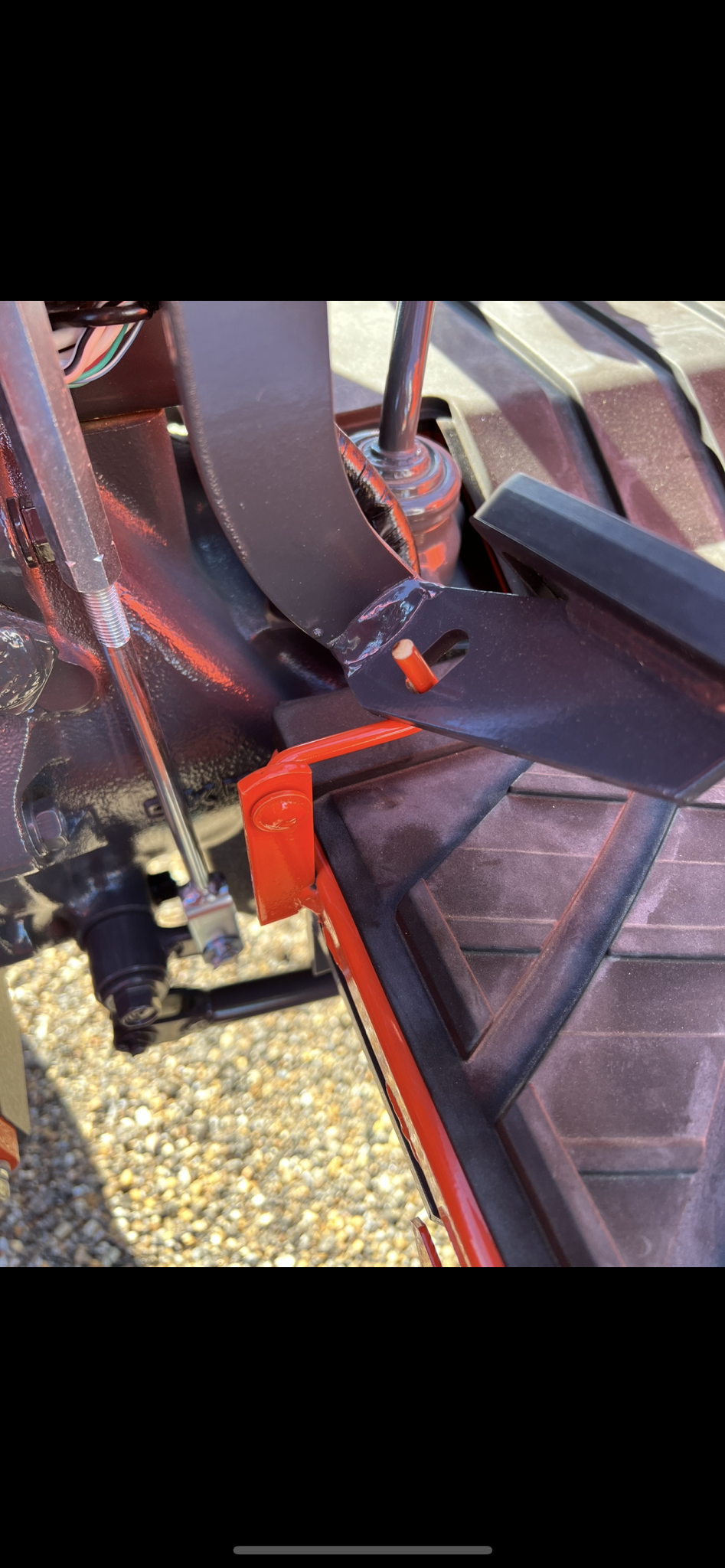

I took this picture last year on a L series at the dealer to fab something similar to my MX.
Nice and clean looking. Funny how they went to the trouble to install a hold down on a L series and not the MX series. Got a piece of lath holding it in now. Guess I’ll paint it orange. Ha. Till I get the chance to fab one like this
