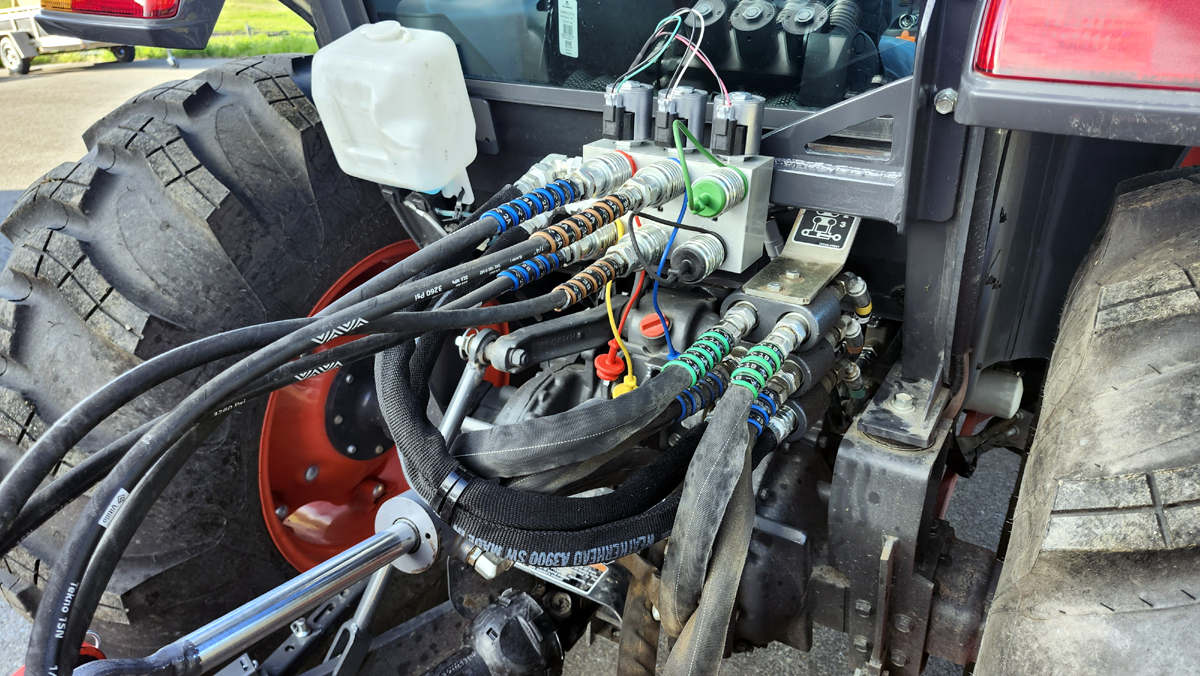

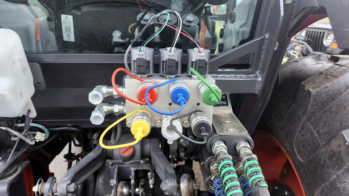

By the way, all three rear remotes cost $1,802 and installation was $229. Well worth the investment, but still not enough for me so I added a Summit Hydraulics multiplier a few months ago that's controlled via a Scorpion control grip in the cab.

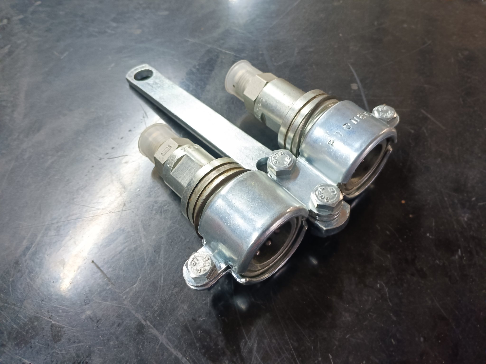

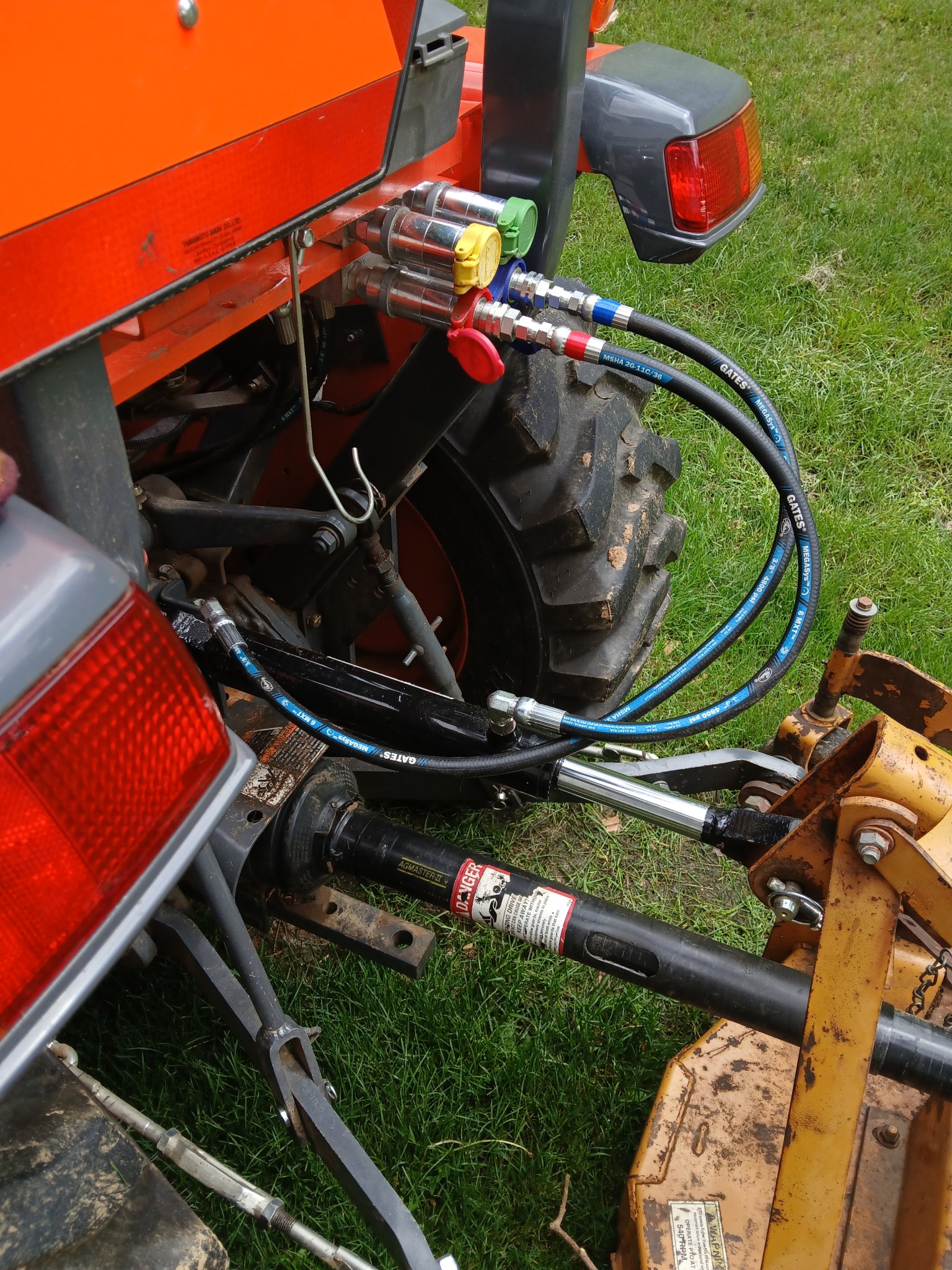

I have spent a lot of time researching Kubota's rear remotes and they have a history of cuttinging corners and locking you in to proprietary components. In many cases their prices are absurd. If you want to roll your own ditch the OEM coupler kits, buy just the bracket, and use this style coupler as found on the big boys.
Faster 4RSHF on a L3901
OEM Remotes on a M7040

The cast iron housings are nothing more than a proprietary and expensive panel mount for $30 two way sleeve couplers. Pure eye candy and could be replaced with two snap rings. I would hope Kubota's new base mounted couplers are push/pull but given their track history ....

The cast iron housings look nice so yeah - curb appeal helps sell tractors. The couplers inside are generic two way sleeve couplers that work exactly the same when clamped or panel mounted. Your Summit vakves have them as well but they are base mounted which defeats the purpose of the two way sleeve. Every coupler OEM offers two way sleeve couplers starting around $25 as opposed to the $130 Kubota wants. My point is quite simpke - nice looking panel mounts are easy and cheap. No need for $100 housings and being tethered to Kubota prices.

I dont know exactly whats inside those cast iron housings but Faster PV two way sleeve couplers would not be a bad guess. Why dont you pop one out and tells us what you find?
Your bigger tractor is getting into the small utilty tractor class and has Faster CFPV sleeveless couplers. They are relatively low end with FKM seals and no connect=disconnect under pressure capability.
The next step up from that is the 3CFPV which adds the capability to connect with male side only under pressure
The ones I am recommending are 4SRHF which is "two steps up" . They have PUR seals and are capable of connect/disconnect with one or both sides under full system pressure.
Bigger AG tractors simply do not use sleeve retraction type couplers and your personal opinion aside Faster has long been the gold standard in that market. Here are two informative videos. The first gives you a good visual of how a sleeveless design works. The second shows connect and disconnect undrr pressure.
