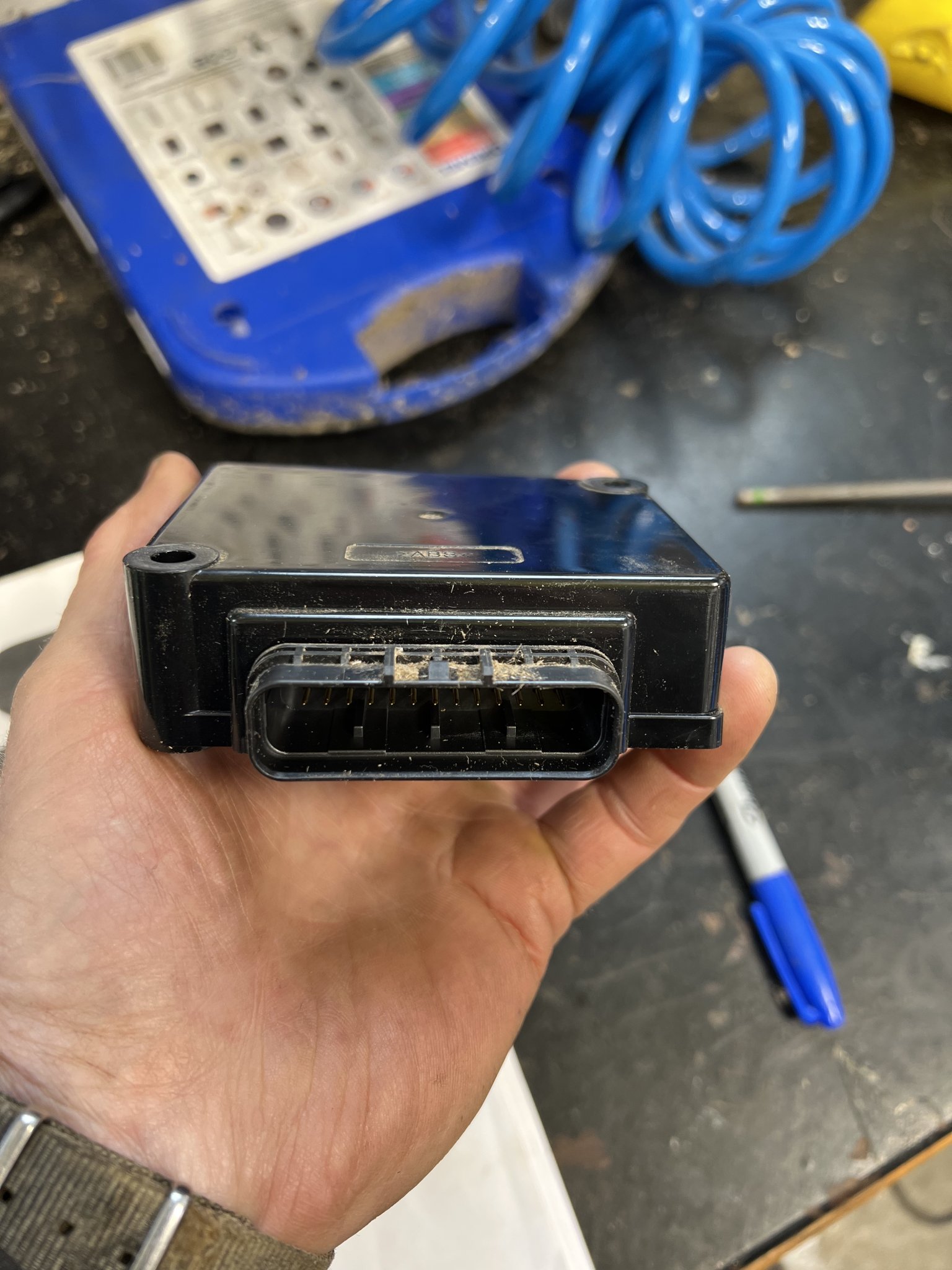

To tackle the problem of no PTO, I wired the PTO solenoid directly to the battery and everything worked fine (i.e. the PTO turned on and off). I then traced the wire that provides power to the PTO solenoid all the way under the dashboard where it terminates at the Electronic Control Unite (ECU) that controls the safety switches. My dealer loaned me a new ECU to see if that solved the problem. It did not. The next step is to determine what powers the ECU and see if I can find a short somewhere in the system. My WSM does not have a wiring schematic for this ECU. Does anyone have access to this? Also, any thing else I should check?
Thanks!
