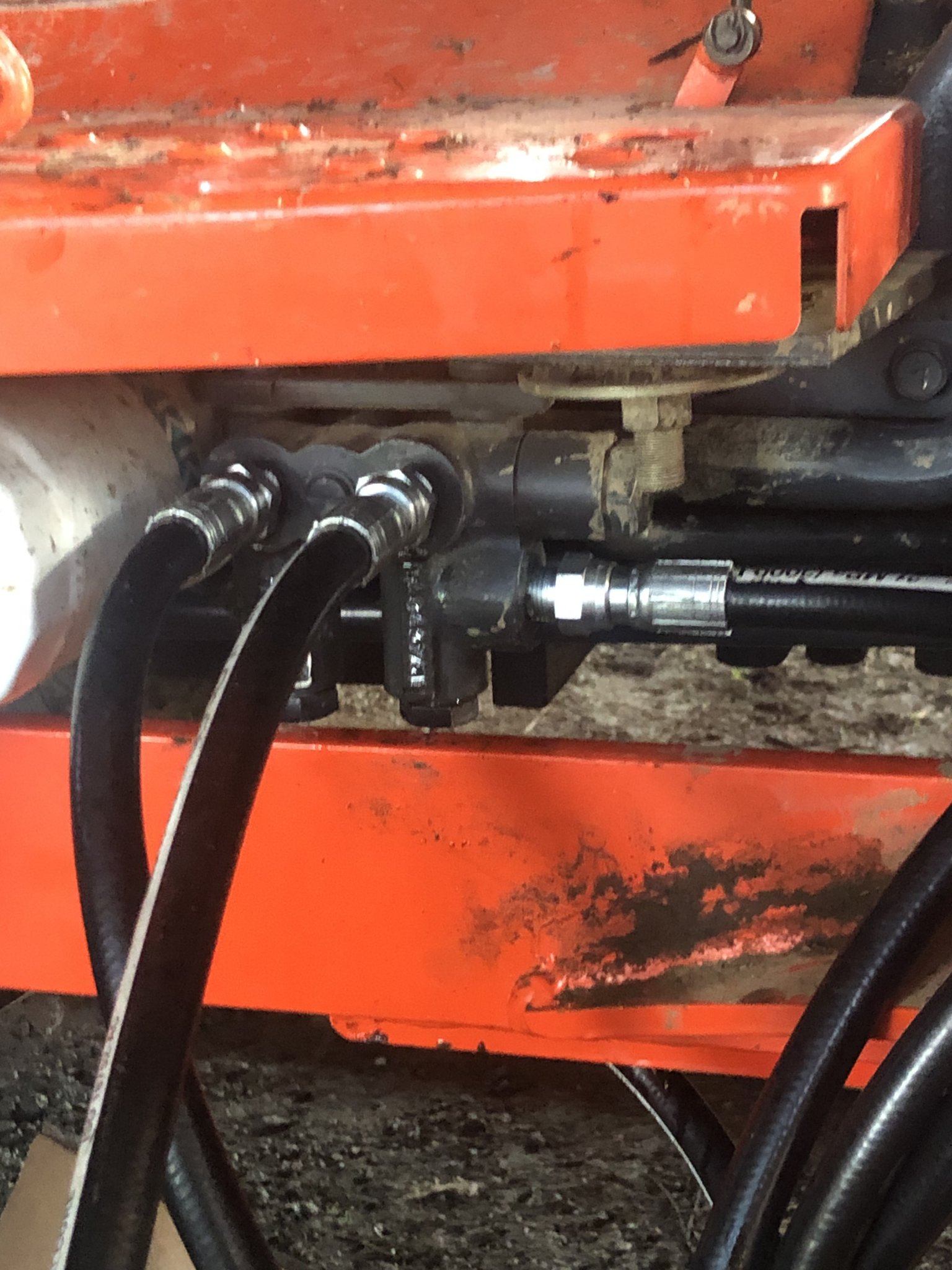

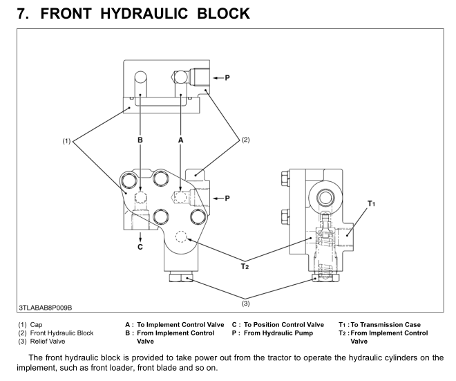

Hopefully a simple question that will save the trial and error on hooking up my la852 loader to my mx5000 tractor. My question, the hydraulic block below the right foot of tractor has 3 hydraulic hoses to hook into the block. What is each port operatoring on the loader and what goes back to tank.
