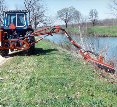

I would consider a boom mower. Bush Hog makes a nice unit, easier to use, but they are all for larger tractors. (10,000+ pounds)
I haven't found one for these "compact" tractors...

That's the option that I'm leaning towards at the moment. I'm going to take my angle meter out there this weekend and get a true idea of what I'm dealing with and regroup.
Kunz makes their mowers with pressurized oiling systems but they are much more money out of the box. If I could find a used one of those, I might be set.
Then all I would have to do is extend the boom arm about 10 feet LOL

I know I got a good deal but I didn't realize how good until now. I found mine for $3k. :eek:
Aside from mowing around the ponds I have been doing some practice and have found a new trick this bad boy does like a champ. If you take time and really watch this is a bush trimming machine. I cut the bushed/shrubs around my mom's house in about 15 minutes. Square front, flat top and no extention cord required. I love it. :D
