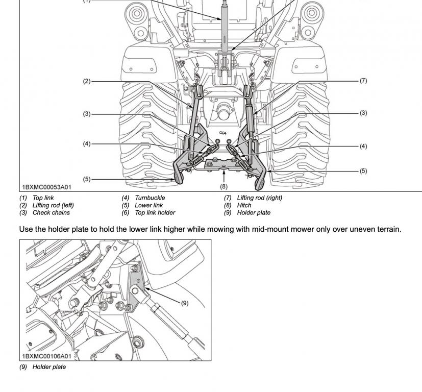

Is it a ballast box on the 3PH? If so just put the pins in the fixed position holes. At least that is what I do with my counter weight.
T,
Like blindbuck says, pin your 3PH as shown on page 55 of your operators manual (also shown in below attachment), it will keep your counter weight up but still allow full movement of mower deck.
