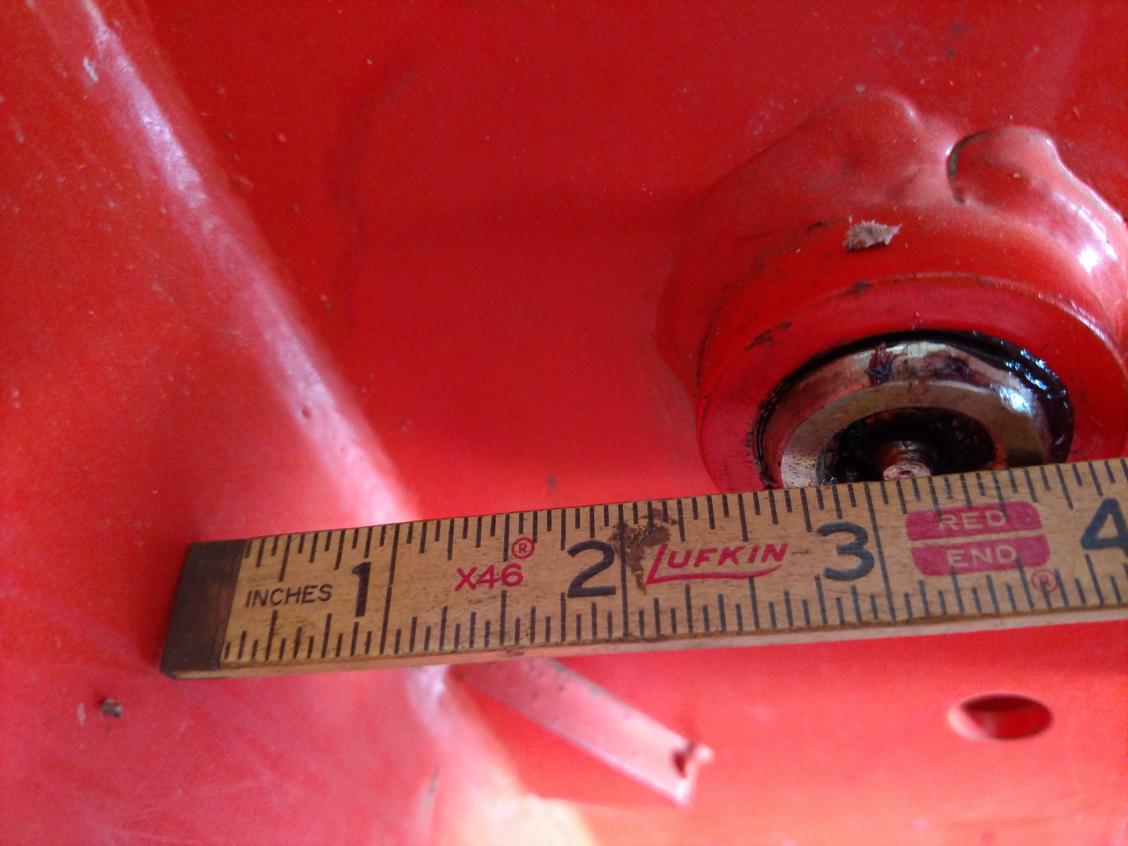

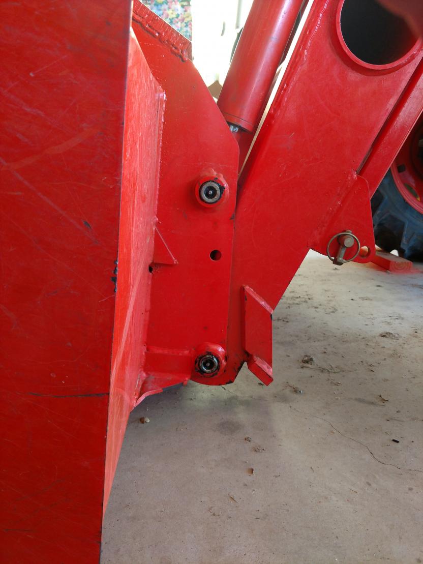

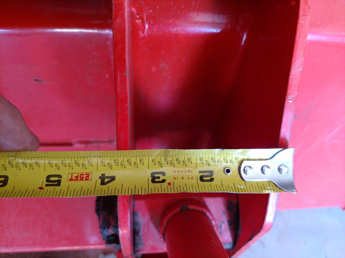

Here's pics of my LA1002 FEL and it's bucket. The distance between the holes are 10-7/16" center to center. The width of the bracket and distance of holes from the back of the bucket are shown. (Sorry one of the pics is upside down... I actually corrected that and reloaded it...and it still posted upside-down... but you can still get the width.)

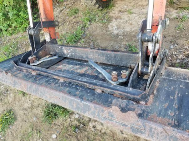

Pin spacing is only one hurdle, pin height off the bottom and I would not count on your back plate of the Kubota bucket to be the same angle as the woods bucket.
These differences will determine if it's even usable, woods angle is a standard angle the same as all SSQA buckets.
If the kubota bucket you have was a cylinder to bucket direct attach without the compound links you'll probably need to rework the entire mount, again see first statement. ;)
Now for determining the distance of the pins:
It's the same distance for the blue line pin spacing as it is for the red line pin spacing, the bottom pin from the ground is the same as the red measurement measured at 60 degrees back, it's a mathematical box arrangement. ;)
Do not match the distance up the back link as it will not match any measurements.
And for angle of the pins with the bucket on the ground and level, 60 degrees forward.

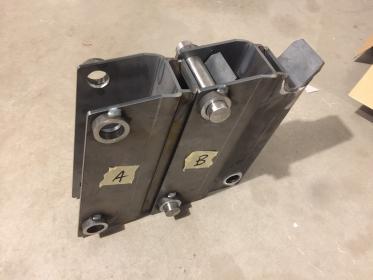

I found a youtube video of a guy who makes a very simple QA that makes ordinary pin-on attachments into QA without a bunch of money or trouble. https://www.youtube.com/watch?v=KuktqggNDCw
The guy who made mine is Dan Heibert: danannah (at) gmail.com
ph: 20four-362-798four (Manitoba)
He made mine and shipped them and accepted paypal. (about $400 but mine were special one-off/custom-made due to special dimensions on my rare FEL.)
They are the cat's meow and didn't require me to modify anything. I leave the top pins in my attachments (bucket and pallet-forks mostly but ordinary pin-on attachments work without further expense or modification) and pick them up with the FEL and then install the lower pins ...and go to work! A few minutes to switch and no help required.
