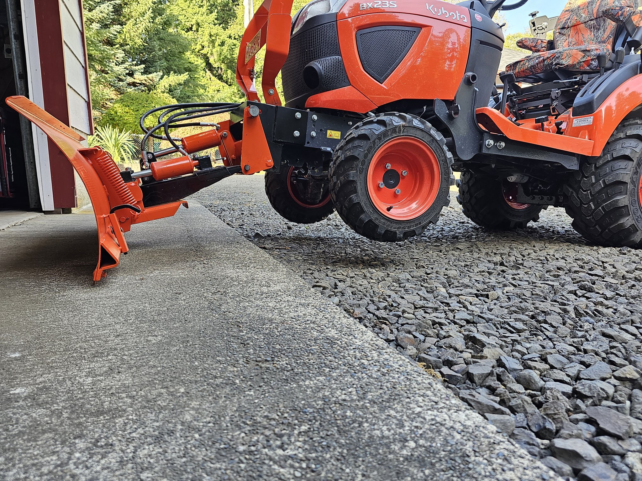

[MOD] Snow Plow - JD to Kubota.
Trimley
BX23SLSB-R-1 plus additions
Jul 25, 2023
1,185
876
PNW-WA
Reactions: 6 users

Nice to see others doing this with their JD blades. I converted my JD 54" blade onto my BX23s probably 3+yrs ago(?). I think i might have even posted pics on here of mine. I never got around to painting mine orange. I left the JD yellow paint on mine. It confuses people when they see a JD blade on a kubota, lol. Mine works very well.
I bought the kubota quick attach manifold for mine so i wouldn`t have to plug in each coupler.
Looks great @Trimley, nice job!

That looks good. It looks pretty far out front. My b7100 gets pushed around pretty good with the blade angled but I'm not sure how that translates to a BX. Hopefully you can go in a straight line when it's loaded up and the blade is angled. Not trying to be a Debbie downer, I'm seriously curious how it performs

I think it will function well. Better than (due to the weight) my previous JDX739 I adapted it too and used for 5 years. It worked great on that one, but the Garden Tractor itself was on the light side. I think it will do well.
I feel pretty confident it will do well. The fittings are no big deal really, though now that you mention it, I may watch for a used manifold.

I tried that route, finding a used one. Almost 2yrs went by, never located a used one, so i bit the bullet and bought a new one from my kubota dealer. It cost me a couple hundred to put it all together, but it was well worth it, to me. With kubota jacking up all their prices lately, i can`t imagine what that manifold will cost today. Could probably check with Messick`s kubota, they might have a decent price on it. I think they might be a vendor in here(?). If they are, maybe they might be able to give you a decent price for the manifold. It does come complete too. All you`ll have to do is hook your 4 hoses to it.

The individual fittings are actually easy to install, they push on without having to pull the ring back, like Pioneer type. They also have a ball bearing detent so you can rotate the ring and lock the mated pair together. To remove, rotate the ball to the detent and pull up on the ring. Pretty easy process.
When I put my hoses together I chose to use 3x Marine Shrink Tubing (in the Kubota dust cap colors) for a permanent method of marking them, as the dust caps were all red.
I've not seen any used manifolds for sale. To my knowledge of reading, the manifolds are upwards of $800.
