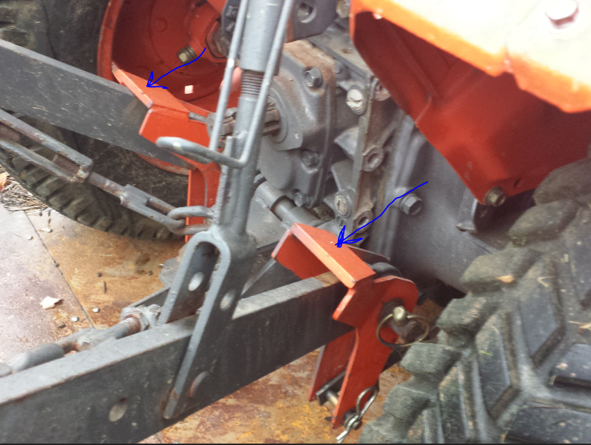

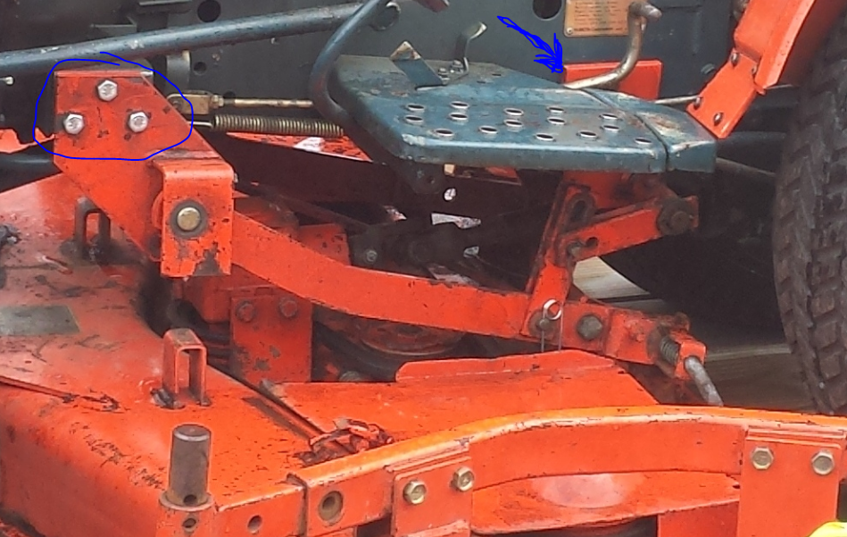

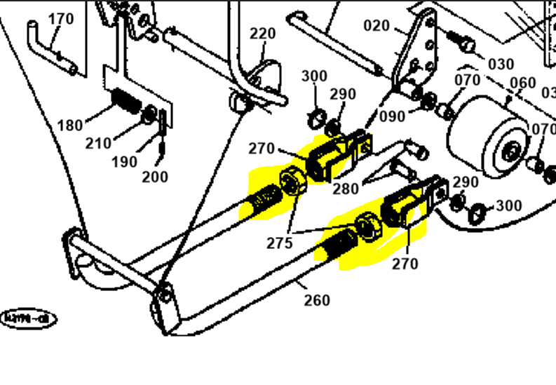

Here are the 3 "parts" of the equation for the MMM
The parts above raise the deck when the 3 point goes up
the front here attaches the MMM via that long arm on the right
You must have these brackets - MAKE sure those bolts circled in blue are tight.
