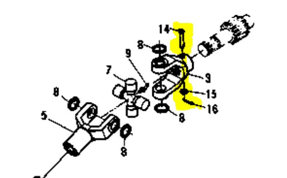

Let me take a flyer. I think you're putting that on backwards.
When I first saw your picture, it looked like the hole was in the center. But second look it seems to be offset to one side. If so . . .
The smooth end slips on the drive shaft splines. Probably will only go one way, but make sure the two drive shaft yokes are in the same plane. Parts 14, 15, & 16 from Wolfman's diagram include a pin. Or find a bolt as large as possible to just fit the groove in the PTO shaft. (probably metric). Then slide the yoke on until the holes line up with the groove and insert the pin/bolt.
