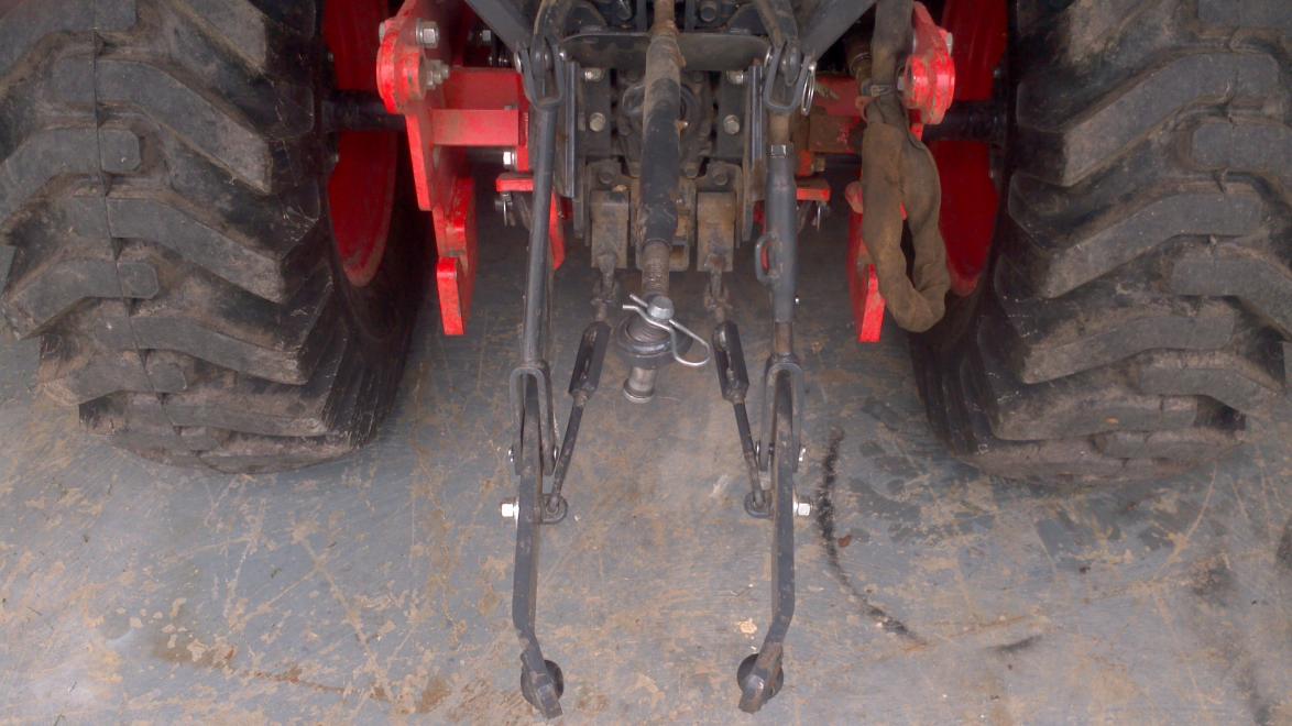

The B3200 uses the 3 point hitch to raise and loser the mmm.
There are 2 rods that are connected to the 3ph when the mmm system is installed on the this B.
You set the mowing height by adjusting the roller and casters on the mmm deck.
The mmm is a ground engaging type mower deck. It is not suspended from the tractor its self.:)

The two rods that I mentioned are attached to the rod that the lower links are mounted on. The brackets that the rods are attached to are on the inside of the lower links on that rod. Even though the mmm uses the 3ph, you can still have an attachment on the rear and attached to the 3ph. You could have a mmm and a finish mower or bush hog attached at the same time and run both if you wanted to.
When you raise the 3ph, both attachments would raise. :cool:

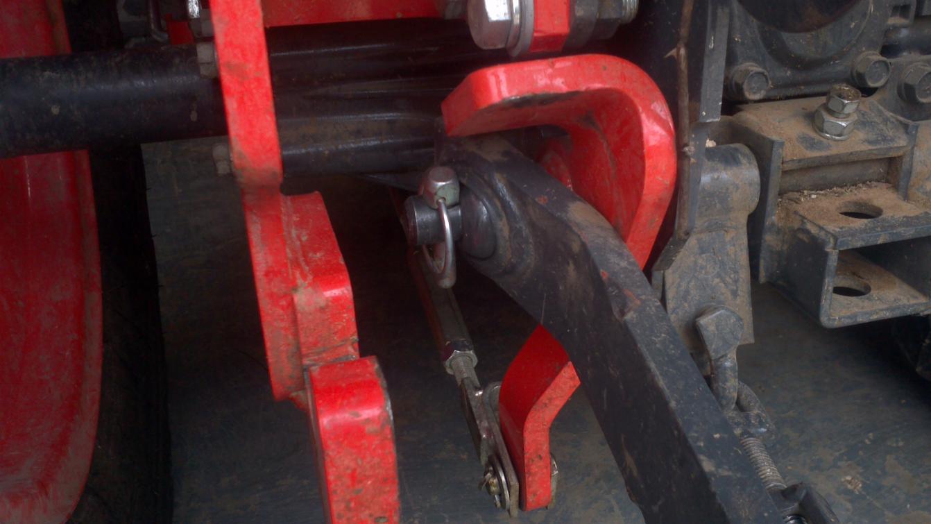

When the 3ph is lifted the orange arm is raised by the lower link, and the small rod on the bottom of the orange arm rotates a link on the mower that lifts the mmm up. Hope this helps you.
