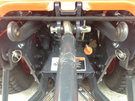

Got around to putting it on today just to check and make sure everything works ok and to figure how they work. Never had a MMM before. So I guess when using a MMM you can't have anything on the tph. I didn't have anything on it today but if I did is there a way to keep it from lowering when lowering the deck. I know you can keep the deck up if using the TPH but I can't figure a way to keep the tph up when lowering the deck if there is a way.
I am not sure of your BX2200 is like my BX1860, but my owners manual showed me how to lock an implement to the frame of the tractor to keep it from moving up and down while raising or lowering the MMM. Take a look at this picture, it should be self explanitory.
