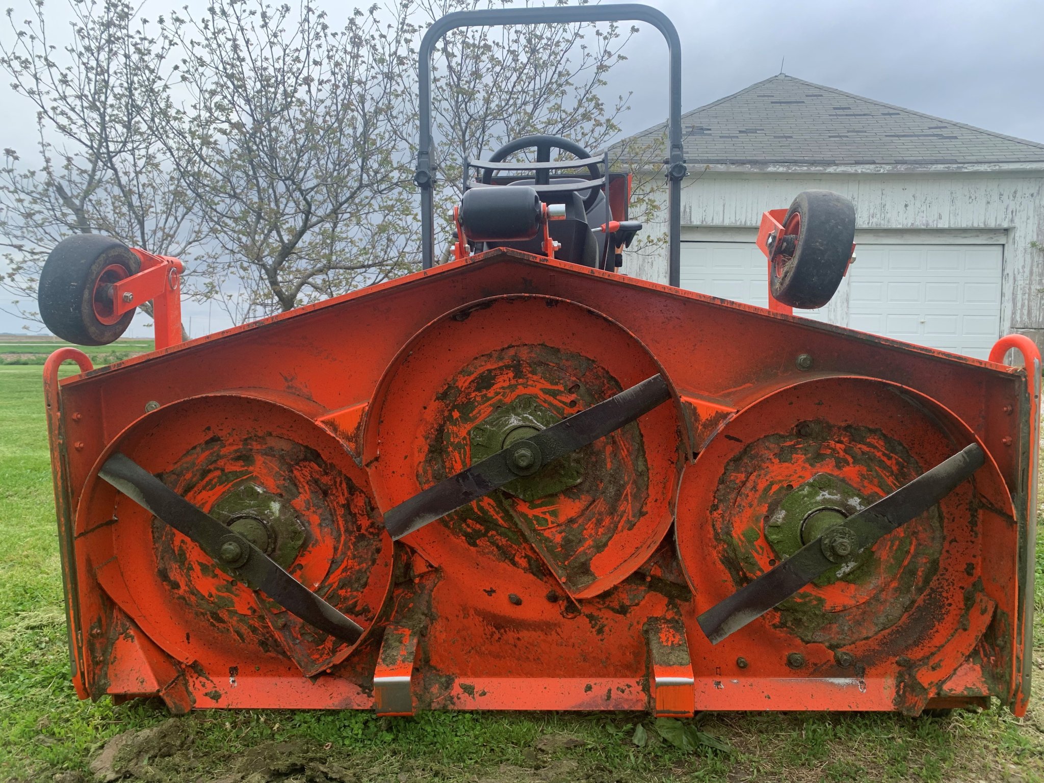

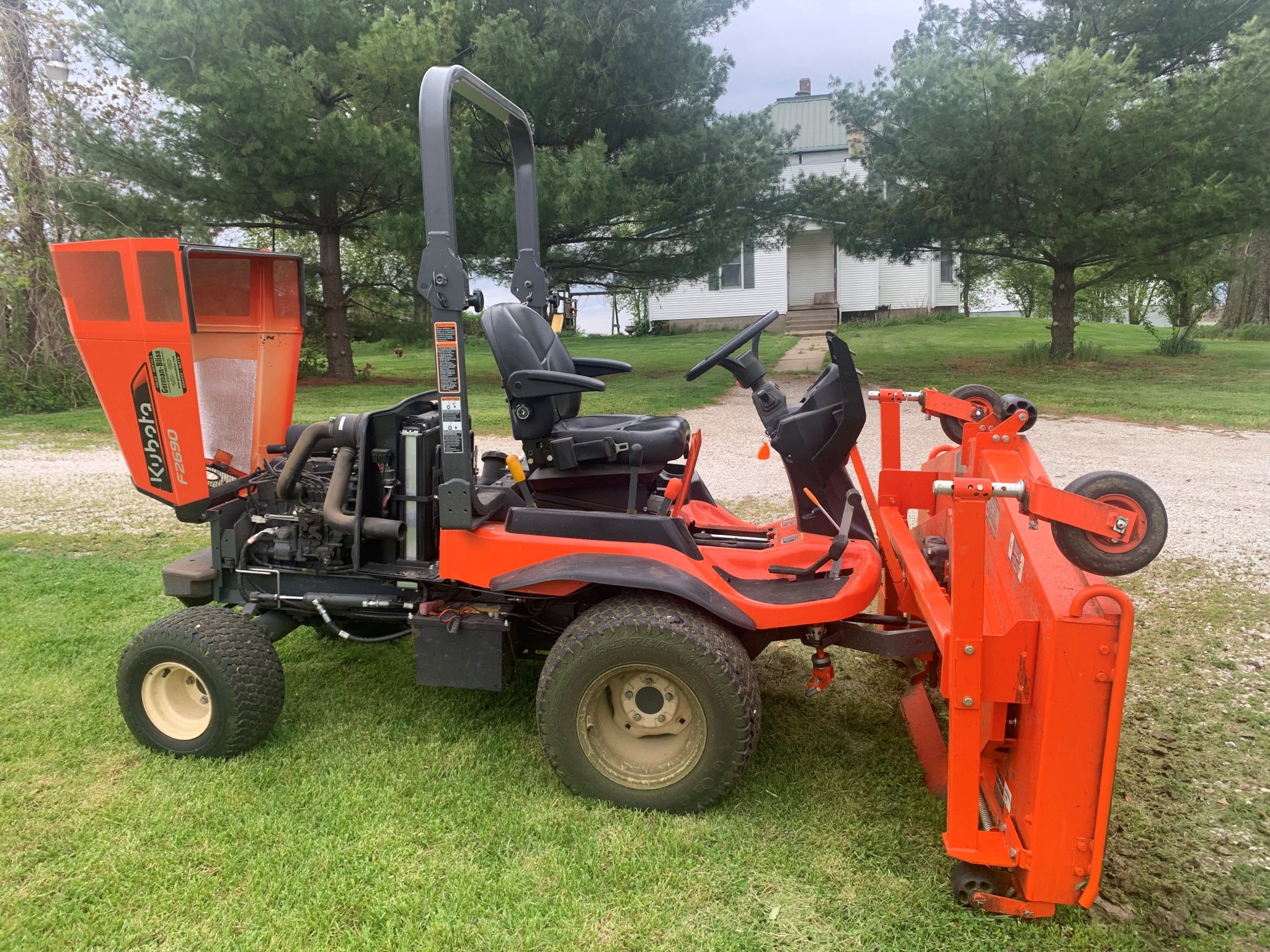

My Kubota F2690 has taken over mowing duties from the Deere and its flip up deck makes changes much easier! With an impact wrench and my "All American" blade sharpener I can take off the blades, sharpen them, and have them back in place and ready to mow in about 15 minutes which is really nice!
