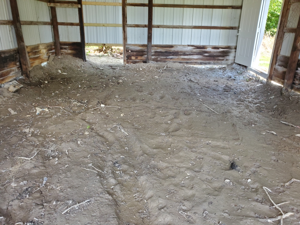

I did this project back in 2021. Pole barn was pretty much unusable. Setting on the lowest side of the property, the dirt floor was always wet. Sometimes like a swamp. The floor was below an already low grade, a lot.

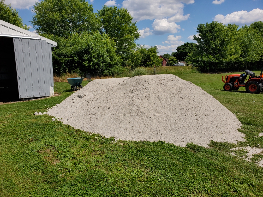

I filled it with ag. lime with my B2601. It smoothed out easily and packed pretty good.

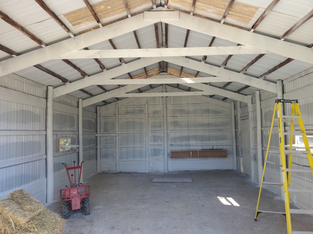

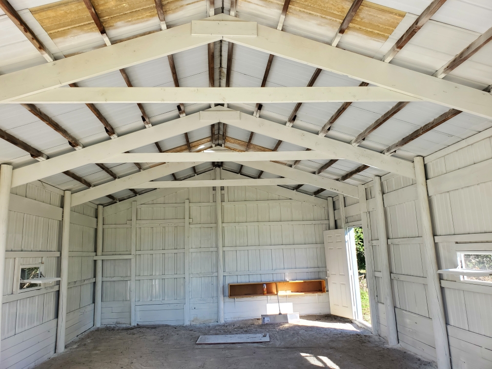

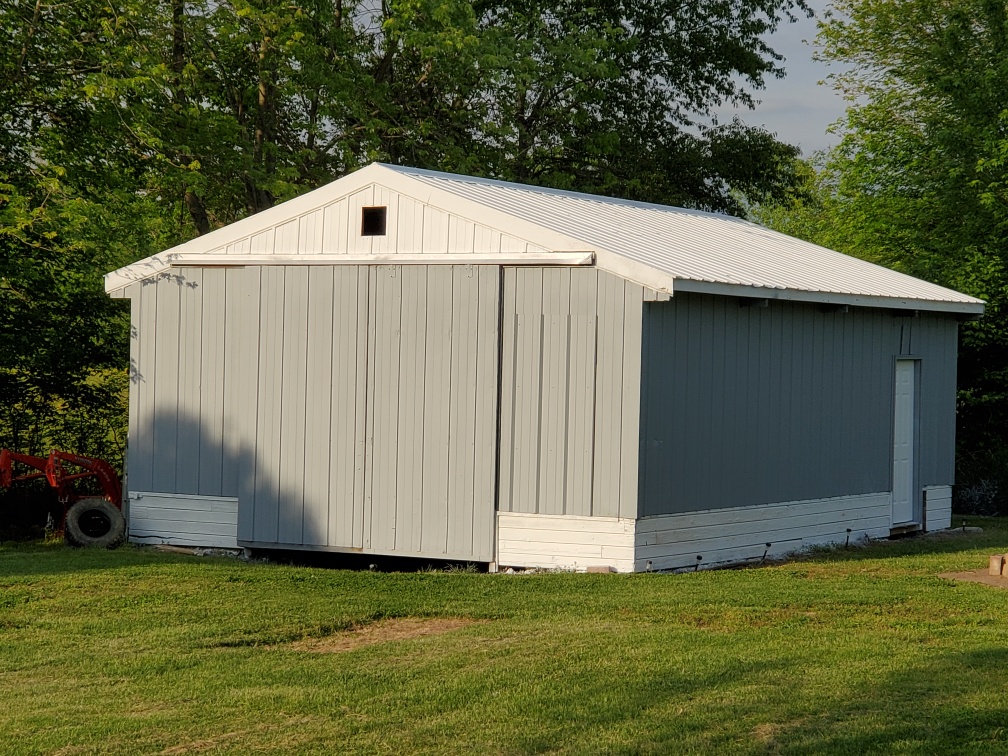

I then used an airless sprayer to paint inside and out.
The lime worked great for my uses. Tractor and implements. Gardening supplies and tools and such.

What did you spray the outside with? Got some rust starting on a roof
Exterior was painted with Valspar Storm Coat.
If you're referring to the roof panels visible from the inside, those were the translucent panels that let light in from above. I painted over them from the top side. Making sure they were well sealed was more important than the minimal light they allowed in. They had yellowed a lot since 1970.
I installed a couple windows in the walls for light.
