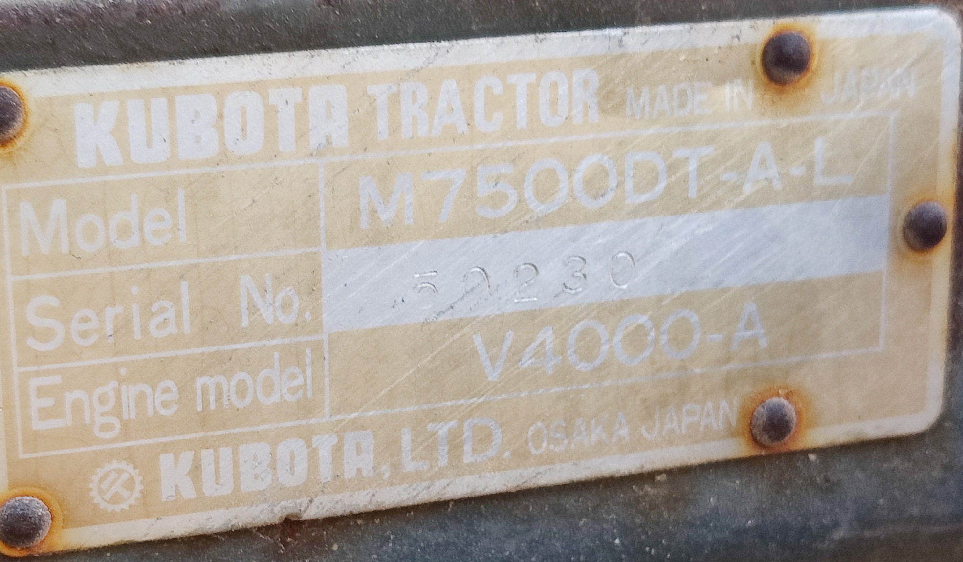

Oktm
Kubota M7500DT
May 12, 2022
38
Utah
Not to necro, but I just thought I would add in case this turns up in searches.
From my research for my M7500DT-A-L:
A = Either USA or Auxiliary fuel tank (Mine had the plumbing for the tank, but the tank had been removed. I ended up removing the plumbing as it was leaking)
C = Possibly means cab? My tractor has the creeper gearing, but does not have this designation(I have High/Low, 1-4, and a creeper lever)
L = Low profile (Exhaust goes down and out the back rather than up through the hood/bonnet and maybe some fender differences. This is usually for tractors used in orchards and other situations where they need good clearance)
Here is a picture of my model/serial plate:
