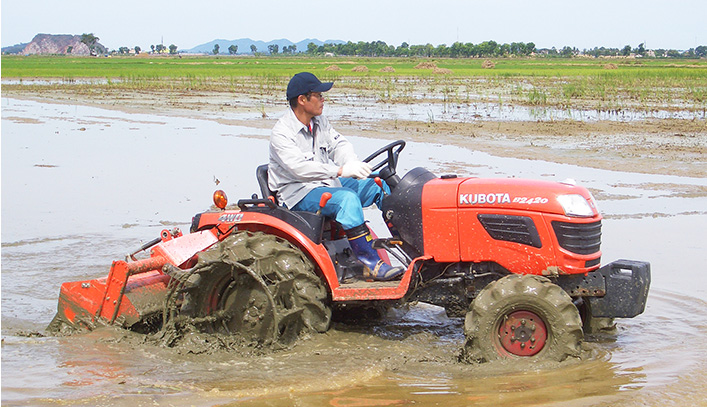

I spend time in Japan from time to time, and have always been fascinated when I see their equipment in the paddies.
Take a look at the link and scroll down to ‘application’…I am not saying this is ok or not, but I did not see a disclaimer either o pic in the paddy

Thanks GrumpyFarmer, def interesting to see this image. Also went and found a couple similar youtube videos of kubotas out in the paddies.
Our creeks are rocky where I'm in them, and not enough current to get swept away. Generally if I'm doing any prolonged work like collecting rocks, it may max at 6 inches. Very solid and nothing that concerns me now, although it was a little unnerving the first time.

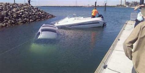

But as per usual, I am sure there is a "point of no return" that some "Num-nut" will try to surpass. Like this guy. hahahahah
Man I would have loved to witness that "first hand" :LOL:

I have "dipped" a few truck/automtive exhausts in the water when taking boats in and out, and I have never had a problem stalling them.
