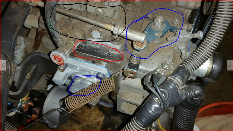

If you have the decompression on your motor. It's gonna look similar to this picture. There's a little rocker on the front end of the motor that the cable hooks too.
Now on my tractor. The kill lever is actually the throttle linkage. The hand throttle lets the linkage move back to the low idle position which is set by spring inside the injection pump.
Grabbing the kill lever, moves the linkage a 1/4" more which moves the fuel rail to the off position.
On some of the B models, the throttle lever works as the kill lever too. Run it down to idle. Then push the lever a little more and it shuts down.
I'm assuming you motor is probably similar.
The kill cable probably hooks to the throttle control on top of the injection pump. You can see the rocker in the above picture. Lower left in the picture under the air intake pipe.

Most likely based on HP and year it won't have a decompression device.
You can find out what size and serial # (in red) you have, it's stamped next to the injection pump (in black).
The throttle control will be hooked up to either plate in blue, most likely the top.
Get a picture of the top of the injection pump like the one I took and I can get you a lot more information.
