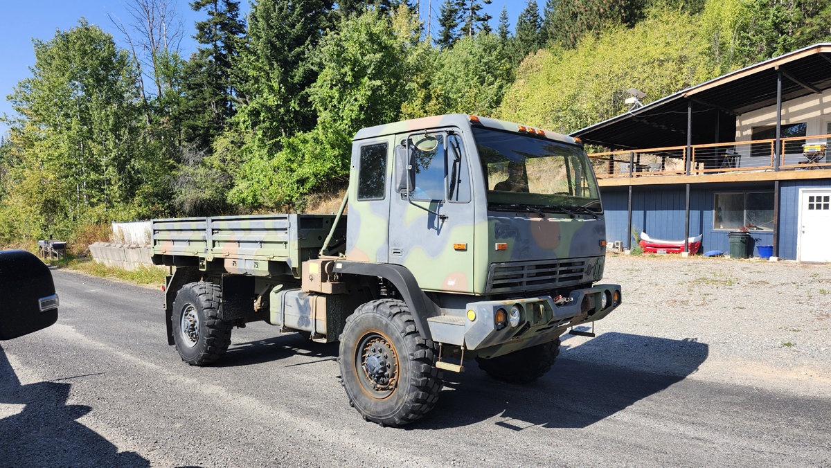

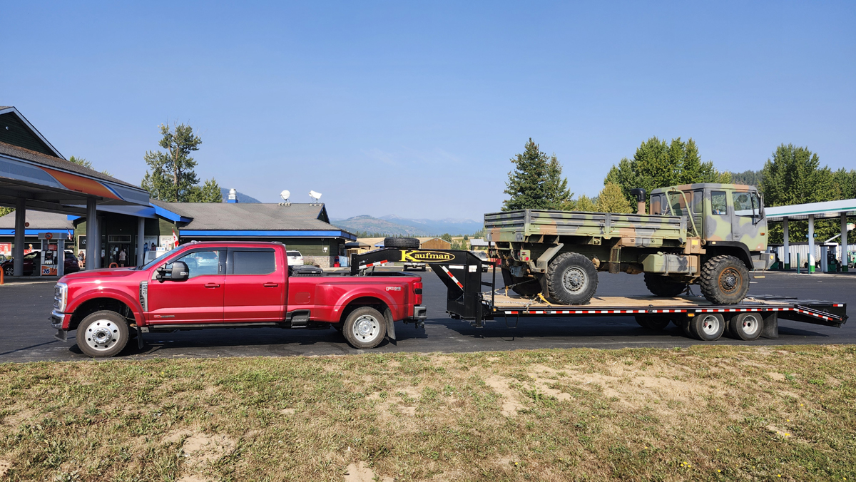

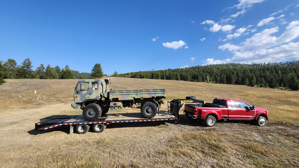

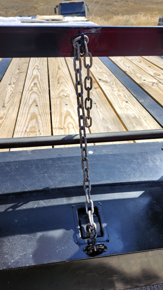

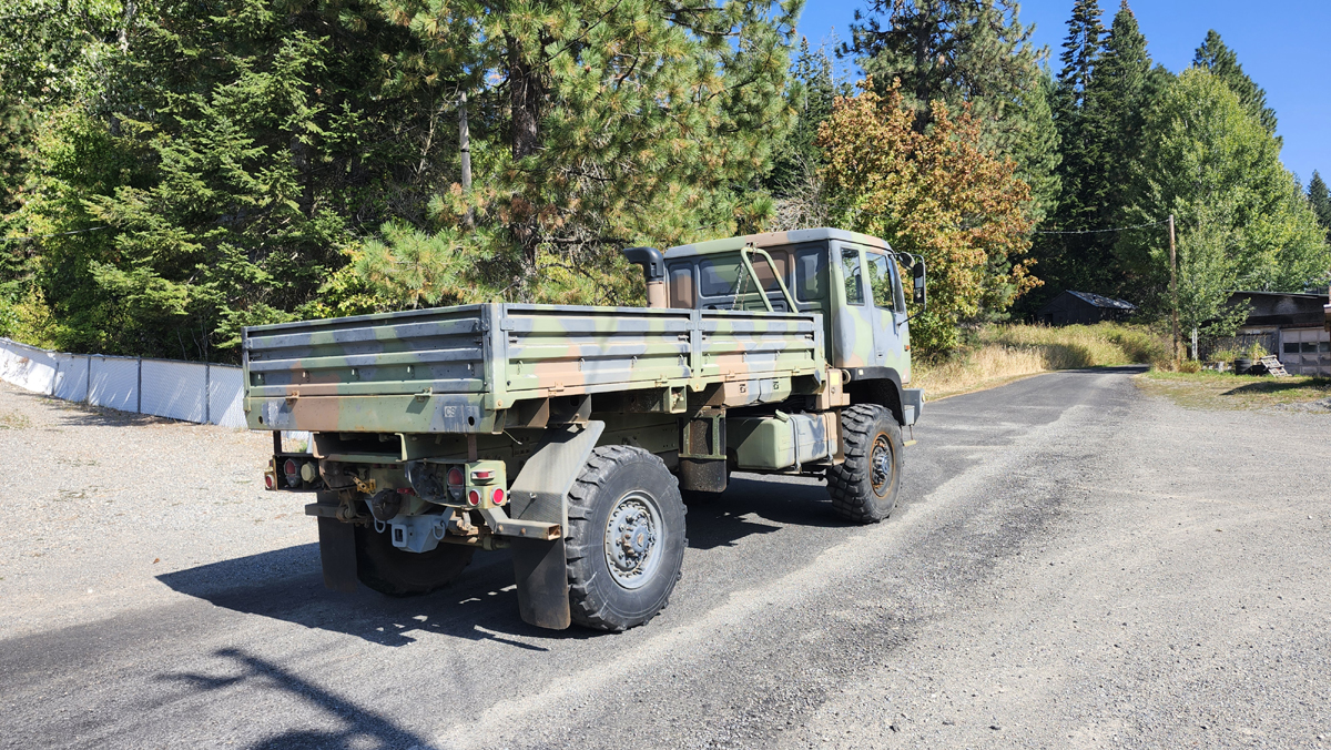

I had zero issues towing the M-1078 a little over 200 miles. I don't like it when chains loosen up but no issues on this trip.

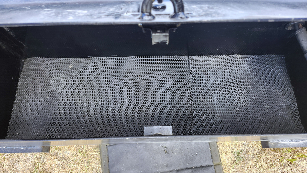

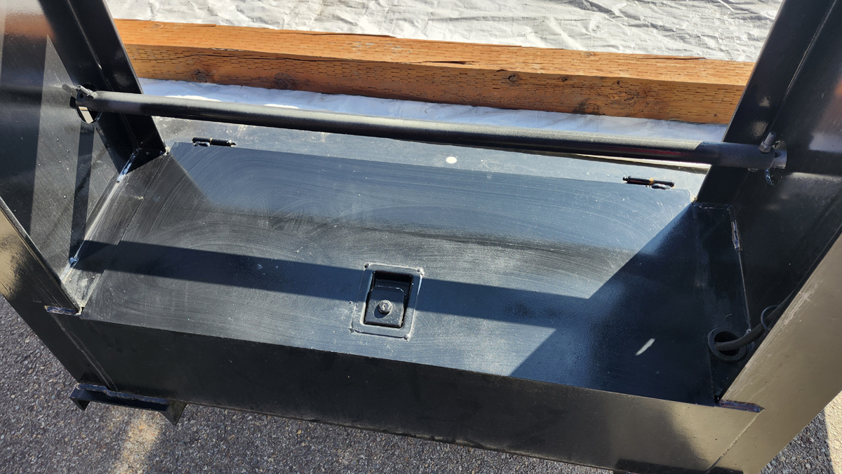

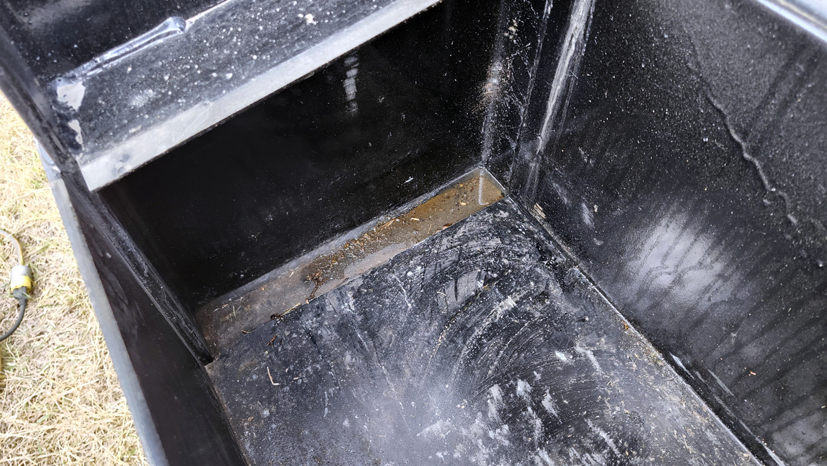

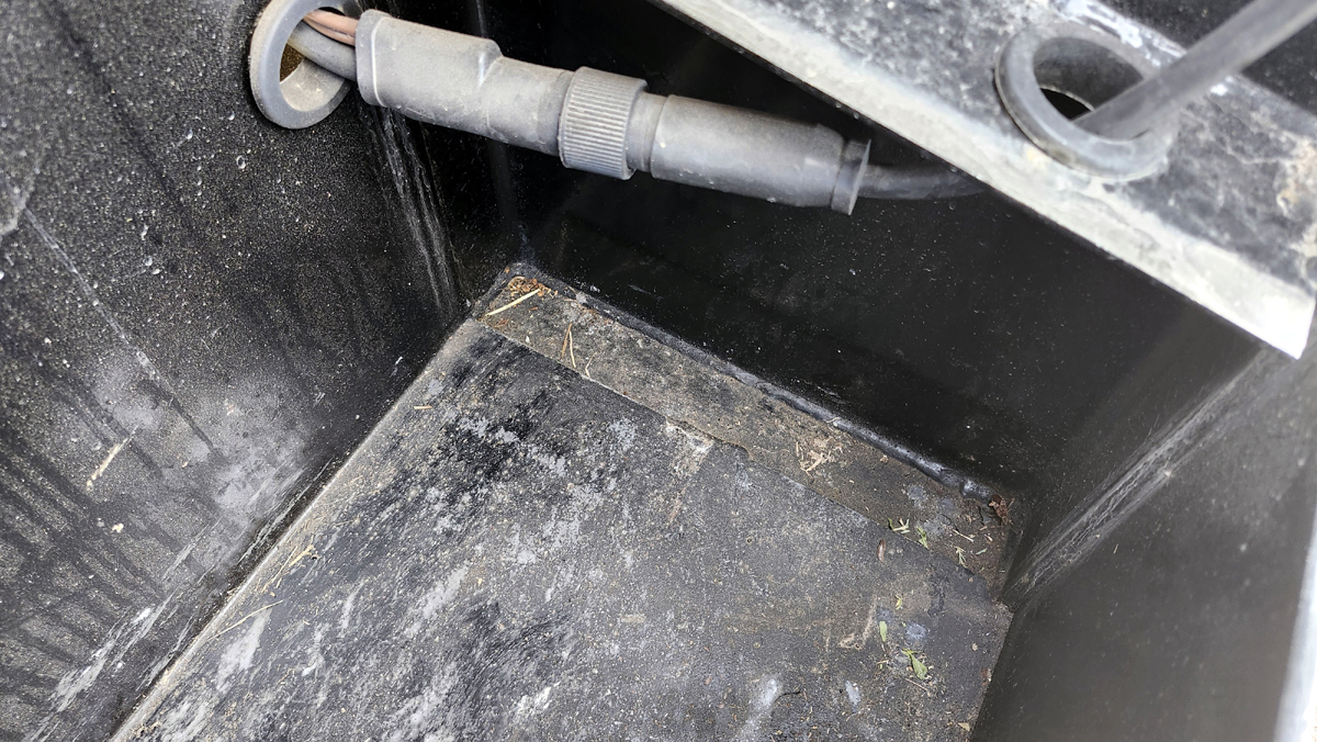

I checked another couple of upgrades off the list this morning. The storage box isn't waterproof, and it would be a fool's errand to try to make it so. My approach is to allow the water out, and to keep valuable chains, binders and shackles out of sitting water as much as possible.
I'm in a 12-step PRA program .... or Pack Rats Anonymous! 😂 If something looks even remotely useful I have a hard time throwing it away, and today's project only serves to validate that genetic disorder. Earlier in the summer while working on boat upgrades I decided that I didn't like the expanded rubber mat in the center console. I put it on a shelf in the garage thinking that it'd be useful somewhere else. It sure was!
For whatever reason, Kaufman doesn't add drain holes in the storage box. The box is built up around the I-beams and C-channel that make up the neck and is more of an afterthought. The bottom of the box isn't fully welded to the C-channel so there is a place for water to get out but it's not a path it naturally wants to take. I used the mag drill to add 1/4" holes in each corner, and then cut up the 3/16" thick rubber mat to fit the box. Now water has a place to drain out and the chains, binders and shackles are sitting off the bottom of the box. I like things to be organized and I'm pleased with this simple upgrade.
6,863
9,335

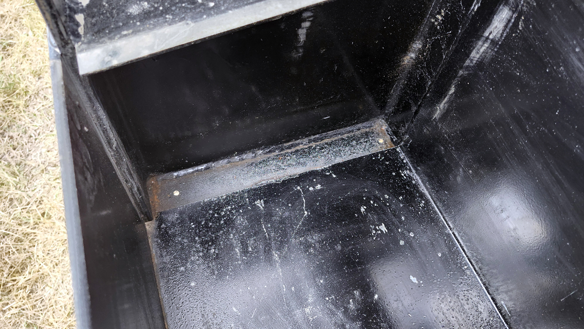

Holes drilled and mat installed.
6,863
9,335

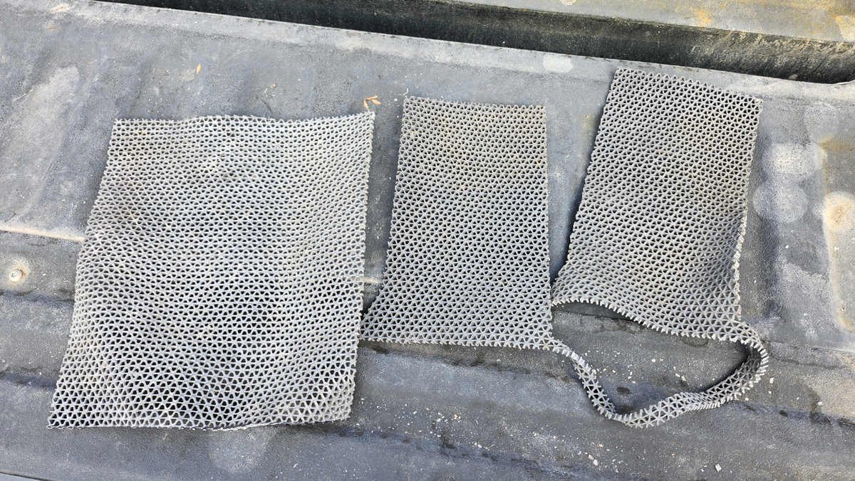

Here's the mat that is 3/16" thick. Once again, hard to throw away the offcuts since I'm sure they'll be useful for something. 😂

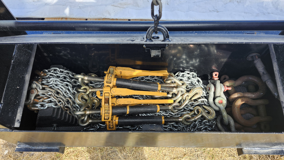

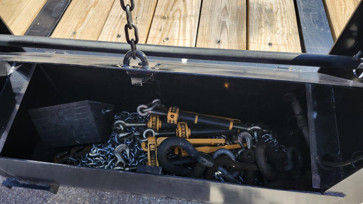

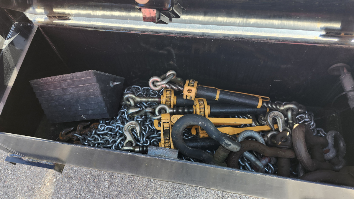

I want to pick up a couple more binders and I seem to remember @The Evil Twin recommending a particular model. The four I have that are shown above are ok but not great and I'd like to try something different this time. I bought the ones I have at a local heavy equipment dealer, and one of them in particular is getting hard to use, and I don't think it's a lubrication issue. I'm not really sure what the issue is at the moment but it's hard to rotate the barrel without using the lever. The other three seem to work just fine.
If there's a particular make that you'd recommend then I'm all ears.

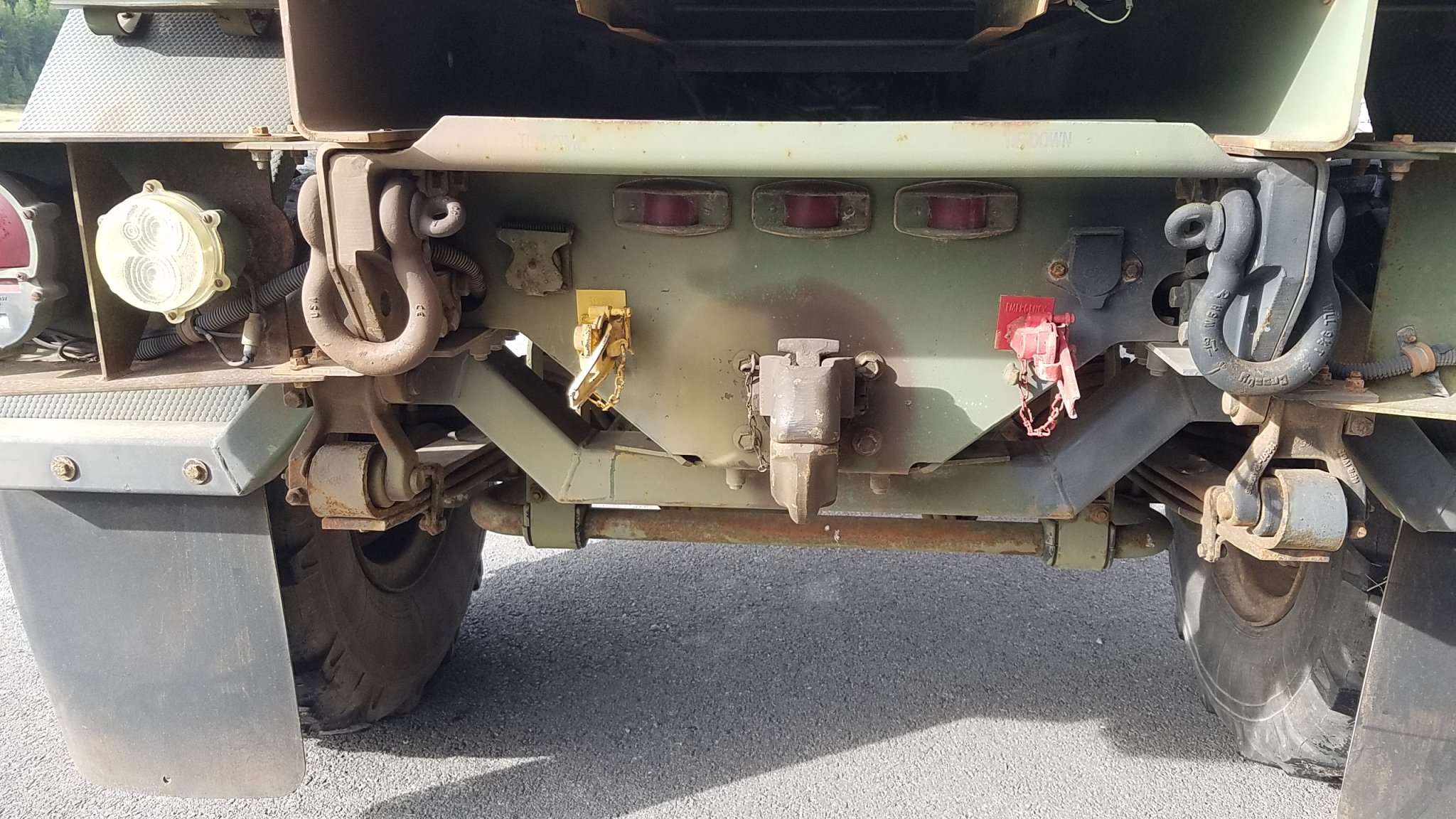

For the record, when my friend in Hawaii told me that he was going to give me the M-1078 he also mentioned that he found four shackles for it. I decided to keep the shackles and not include them with the sale because I really like them, they're useful, and my friend went out of his way to find them.

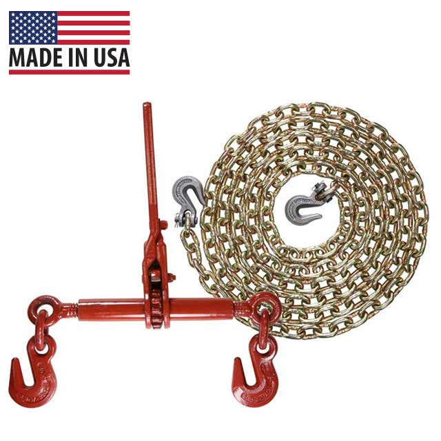

It might have been CM binders. That is what I have. USA made and been happy thus far!

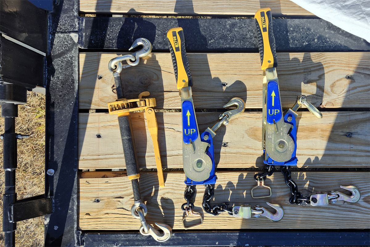

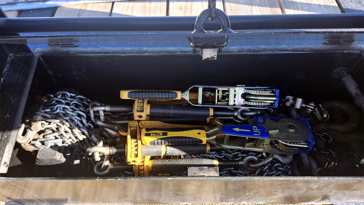

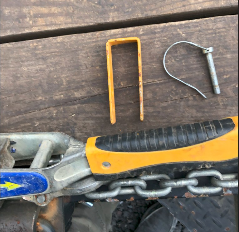

The two binders showed up this morning via FedEx. They shipped from Ontario, Canada and look to be of high quality and are heavier than I expected. Not sure if they're made in Canada but I couldn't find any "made in China" verbiage on them, just some US patent numbers.
Here's a photo comparing them to the size of the Peerless binders that I have. I now have enough chains (six), binders (six) and moveable D-rings (6) for most situations, and everything fits easily in the storage box with plenty of room to spare.
