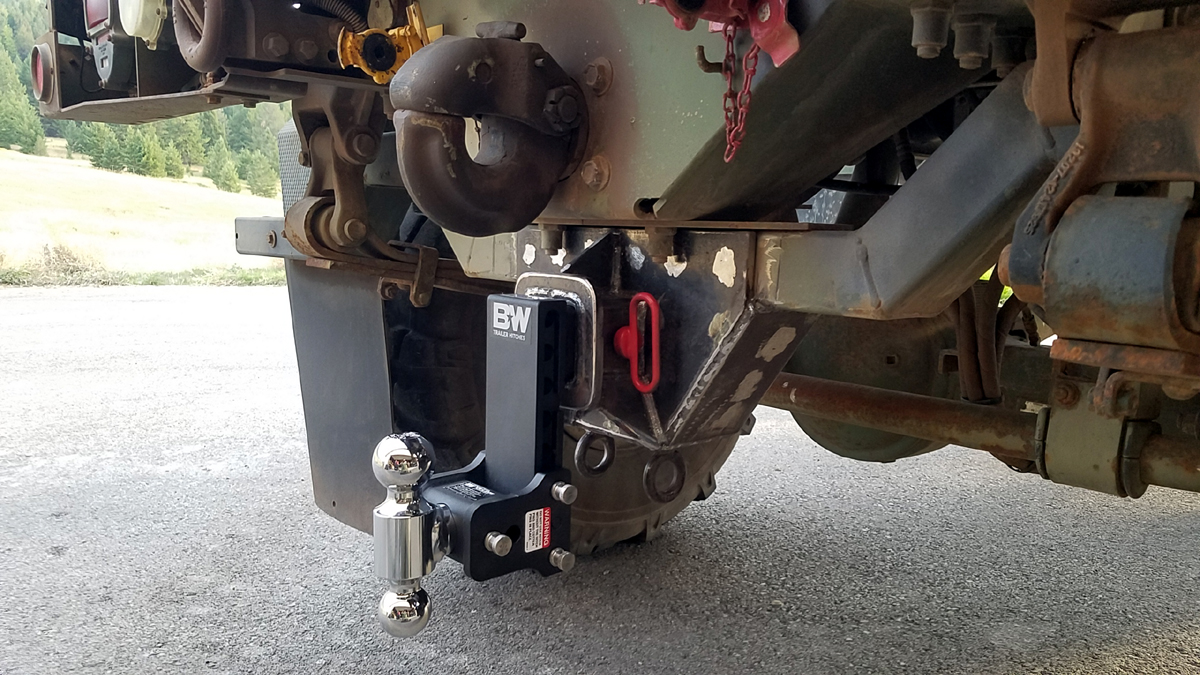

I'm pretty much done with the receiver. I added three 3/8" thick gussets, boxed in the back of the tube, boxed in the plates, added a 1/2" thick "ring" around the end of the tube, and welded everything up using 7018 rods. I'm pleased with how it turned out, and after test fitting it to the truck this evening and confirming that it slides onto the 4"x3" rectangular tube with ease I'm looking forward to welding it on tomorrow.
The receiver plates are 15" wide to give some idea of the size of this thing. I'll need to do some clean up with the receiver on the bench rather than on the back of the truck but it won't take long. I'm debating adding some rings or eyes for trailer safety chains. If the chains will reach to the two shackles above the Pintle hitch I won't bother, but if not I'll probably add something.

There's going to be 50" of 7018 weld between the receiver and truck frame. The 4"x3" rectangular tube that this receiver will mount to is bolted and welded to the big plate that the Pintle hitch bolts to so I think this will be plenty tough. :ROFLMAO:

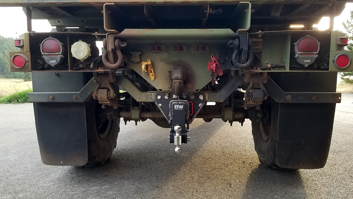

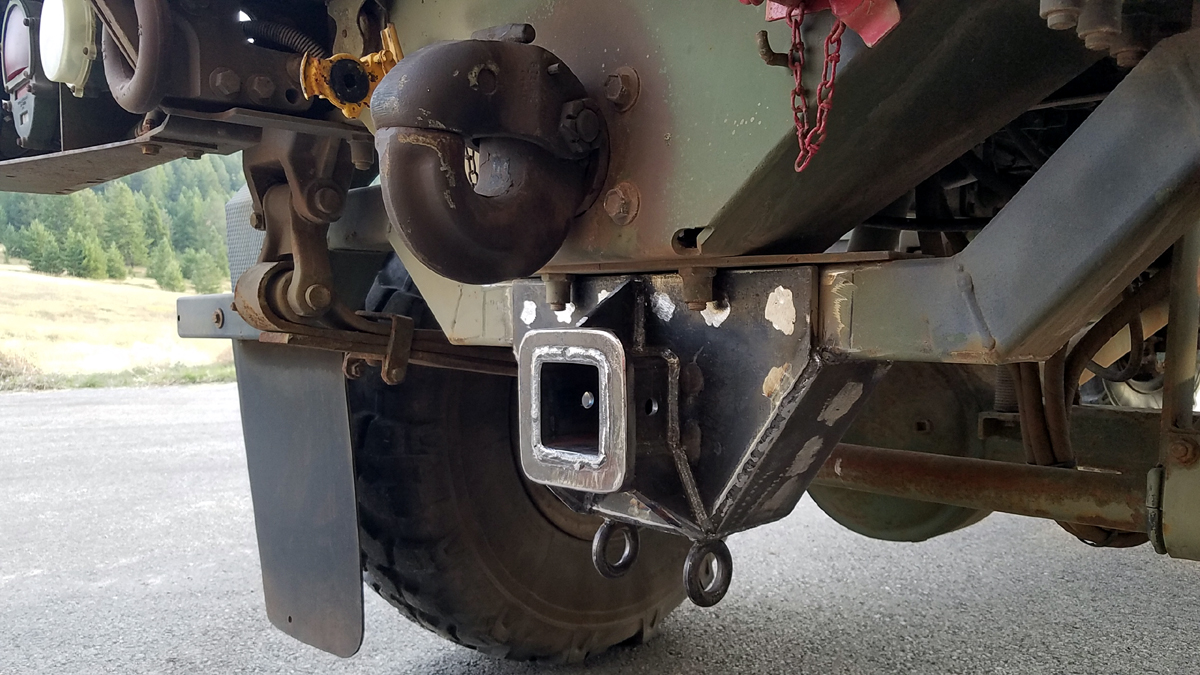

I added a couple of repurposed rings for trailer chains but I'm not sure if they'll stay. They looked better when I was welding them on but look kind of weird now. The receiver is positioned and tacked in place so now to the final welding.
The hitch looks really good. Not too heavy, not to light, like it was stock. I’m guessing it will be painted to match.
The Pintle does dominate the backside tho. I believe you can pull anything you wish.
I agree with your assessment of the rings. I'm not a fan. Not hideous, but just a little "clumsy" looking.
Maybe a "triangular piece" on the angled part that does not stick out as far, or points rearward instead of just dangling straight down?
Either way, nice job!

Yeah, I'm definitely going to cut off the rings and do something better. They're functional but aesthetically challenged. I was being lazy trying to use what I had, but cutting holes in a piece of plate and making something functional and visually pleasing is worth the effort. I don't plan on revisiting this once I start pulling trailers around.

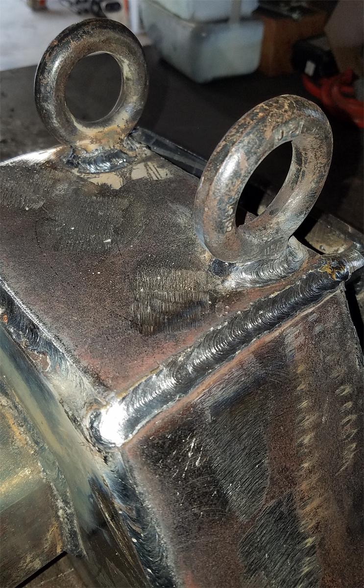

Bit of an update. I bought a couple of 18,000lb rated D-rings from the local steel supply place and made up two mounting plates using remnants from the 1/2" thick plates I used for the receiver. In addition to providing a more elegant and functional solution for trailer chains, I'm also stiffening up the 4"x3"x1/4" tubing that the receiver mounts to. I'll post some photos of these plates installed later today.
I welding these D-rings onto the plates using 7018 rods so this is plenty strong. I beveled the edges of the plates where they butt up to the receiver so that I can get plenty of weld in there. I also increased the bevels on the D-ring mounting pieces (not sure what they're called) so that I could get a lot more weld in there too. Each side take two passes of 7018 to create the finished weld profile.
