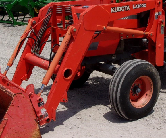

I once owned a M4900 with a Kubota LA1002 loader that had a Kubota attachment similar to what Rara1735 is referring to that what I'll call a quick attach for bucket/bale spear. It wasn't as easy a SSQA but it sure was quicker than removing/lining up/inserting 4 pins instead just 2 pins after attachment was seated in quick attachment. I think kits are available to install SSQA on older buckets/fels.

I once owned a M4900 with a Kubota LA1002 loader that had a Kubota attachment similar to what Rara1735 is referring to that what I'll call a quick attach for bucket/bale spear. It wasn't as easy a SSQA but it sure was quicker than removing/lining up/inserting 4 pins instead just 2 pins after attachment was seated in quick attachment. I think kits are available to install SSQA on older buckets/fels. View attachment 47010
There are but, they all entail the addition of the loader mounted 2 pin SSQA attachment and the bucket has to be retrofitted with a QA plate.
The design (you picture was, I believe Kubota's attempt at a SSQA but the issue was, it's a non standard design. The true SSQA's will all interchange implements. Don't matter if they are European or ISO. Only the pin spacing changes and the locating slots in the QA plates are all long enough to accommodate both flavors.
1st you state it's not really a quick release then you state it's Kubota's 1st attempt at SSQA!!!! Which are you going to agree it is??
After owning/utilizing one I think it's a poor attempt at building a quick attachment for FEL attachments but I think I didn't refer to it as a SSQA but as a ""quick attachment""
Like I posted..." The design (you picture was, I believe Kubota's attempt at a SSQA but the issue was, it's a non standard design."
My opinion on a non standard design. With an industry standard now (except for JD of course), the 2 pin quick attach is universally accepted. Think we can credit skid steer manufacturers for that. All of them employ it, even JD (I think at leasrt don't know 100% as I don't own one)
