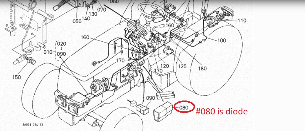

I took a quick look at the electrical systems for a M9000. There are several variations and what follows is a quick reaction not the result of hours of studying the system.
There is a diode electrically located between the two leads to the engine stop solenoid.
Often a diode is used to stop back feeding of a circuit from another circuit or in other words to keep to connected circuits isolated from affecting each other.
The image available from Messicks parts illustration shows a small component but I have not seen one so I cannot comment further.
The diode is located where shown as #080 in the illustration below.
Note the location electrically circuit wise of the diode between the two power leads to the engine stop solenoid.
The above is a quick reaction to the symptoms described. Spending a little time trying to locate the diode and verifying its condition is my best suggestion. Others may have more direct experience with M9000's.
Dave

Looking at the diagram that Dave posted, there appear to be four devices with coils grouped.
As kubotafreak points out the diode is there to control current flow.
As the coils are fed power and disconnected, they release energy back into the circuit. This can lead to "dueling relays" which give a characteristic chatter.
Diodes usually fail totally open or totally shorted. Easy to test with a VOM.

Probably easier to test than to find. The diode in question is in plain sight on the diagram, but what about on the tractor?

If, when you look at the tractor in the area marked in the parts illustration and cannot find it, take some photos and post them,
None of us from what I hear/read has actually had anything to do with such a diode on a M9000
The diode costs $16.63. Part number 36330-75390
If you have a dealer close by, visit them with your tractor serial number and ask if they can tell you if your tractor actually has such a diode.
As I said in my first post, there are several variants of M9000 and each has slightly different wiring arrangements.
Messicks parts system says that diode is used on 99 different Kubota models.
Further, the involvement of this diode with your issue is just my best guess.
Investing $16.63 to buy a part to help you find it on your tractor is not unwise when you consider the cost of having a tech visit and diagnose the problem. Electrical troubleshooting is difficult and time consuming and going through a few hundred $ in labor would not be uncommon.
We will all continue to try and help as best each of us can.
Dave
The diagrams are pretty accurate, given the exploded nature of the picture. Just look above and to the right of the starter. The diode terminal will be yellow or white. and taped to the main harness. It looks like a dummy plug.

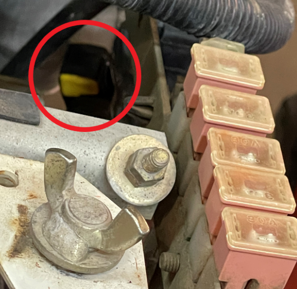

I know I'm late to the party here, but I'm wrestling the very same issue on my M6800. The engine starts, but sometimes dies a couple of times before running steady. It shuts off normally with the key. The diode in question is located under the dash on my tractor. It's bright yellow and taped to the outside of the wiring loom with blue tape. It's in plain sight once you take the top off the dash. My diode tests OK and I get full battery voltage on the output side of it. But I only get about 6 volts on the small wire that plugs into the fuel shutoff solenoid when the main switch is in glow position. When the diode is unplugged, the chattering doesn't occur, but the engine won't start either. I've studied the wiring diagram for hours, and tested everything I can find to test. I can only conclude that in my case the wire is shorted or almost broken somewhere between the diode and the solenoid. I've replaced the solenoid and the timer with no change. My next step will be to run a jumper wire directly from the diode to the solenoid to see if that fixes it. If anyone finds a fix, please post it!

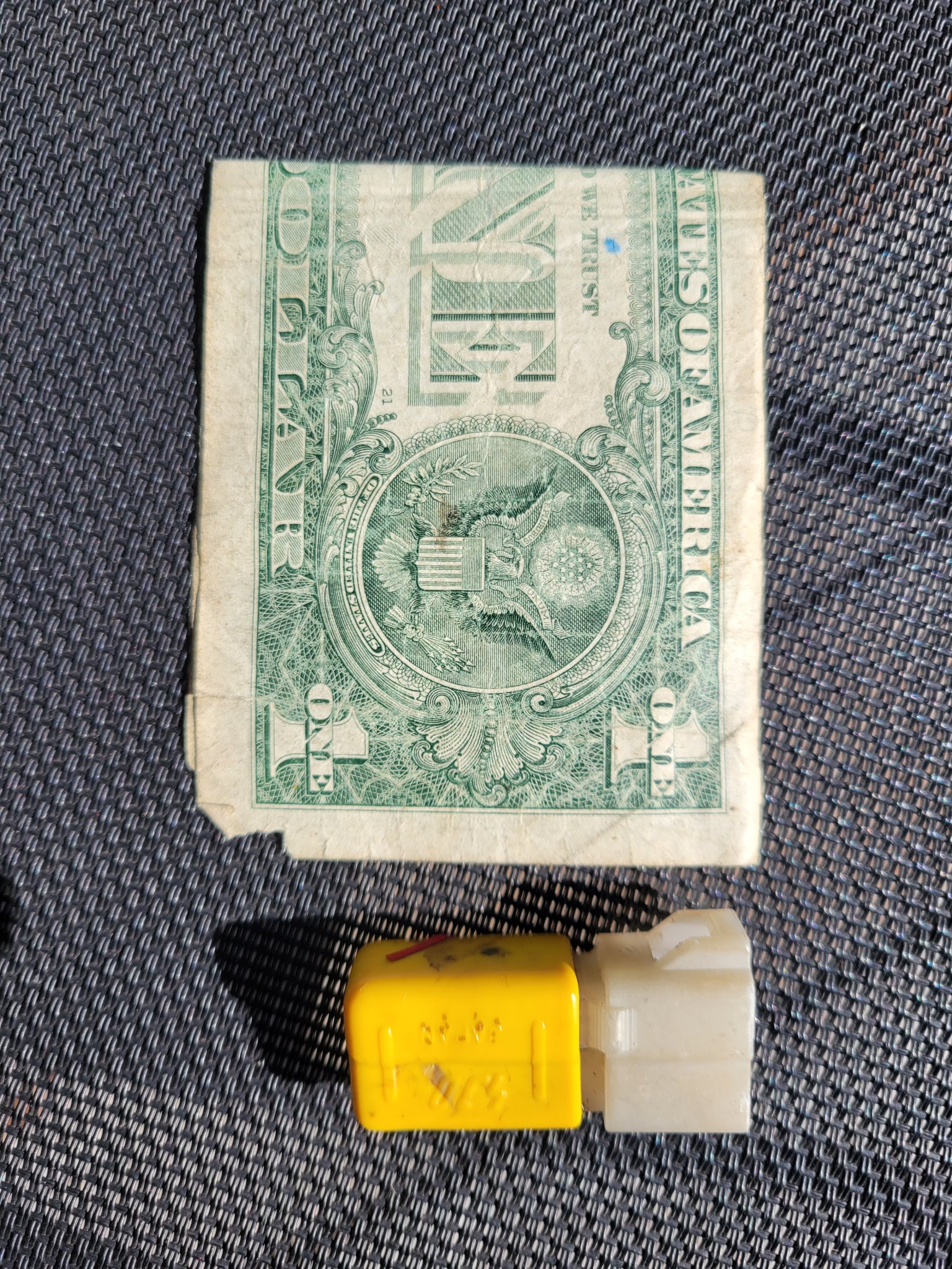

The diode was the fix for our M9000. Several years ago we had the rapid clicking issue. We had to replace the shut-off solenoid twice- very expensive, & neither stopped the clicking. No mechanic or parts guys I talked to knew what the problem was. I finally found a mention of the diode on a forum.
There are actually 2 on our M9000- one is just behind the battery (L side) taped to a wire harness with some other wires. We tried it first; no luck. The second is behind the alternator off the wire harness; this one fixed the clicking.
Now it's about 3 years later & the clicking started again. First we tried the alternator diode; no luck. I couldn't remember where the other one was, so that's what brought me to this forum thread. It's not shown on the schematics at the top, so we followed the harness & found it up behind the battery. Tried it & Bingo! It stands to reason it was the diode that we didn't replace the first time. Due to the current economy, the new diode was $23.

I just had this exact problem.
Tractor has a cab.
Found two diodes under the dash, but they were ok.
Finally found one by the alternator and it was ok.
After a lot of searching through dust/ debris covered wire harness, finally found the one behind battery. Very hard to find. Was taped to underside of large wire harness and looked like a connector in the harness.
Cleaned off dirt, untaped it and found this one blown.
Changed it out and everything works ok now.
Thanks for the info
