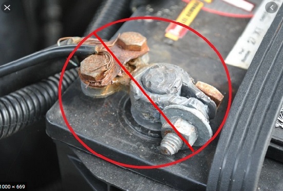

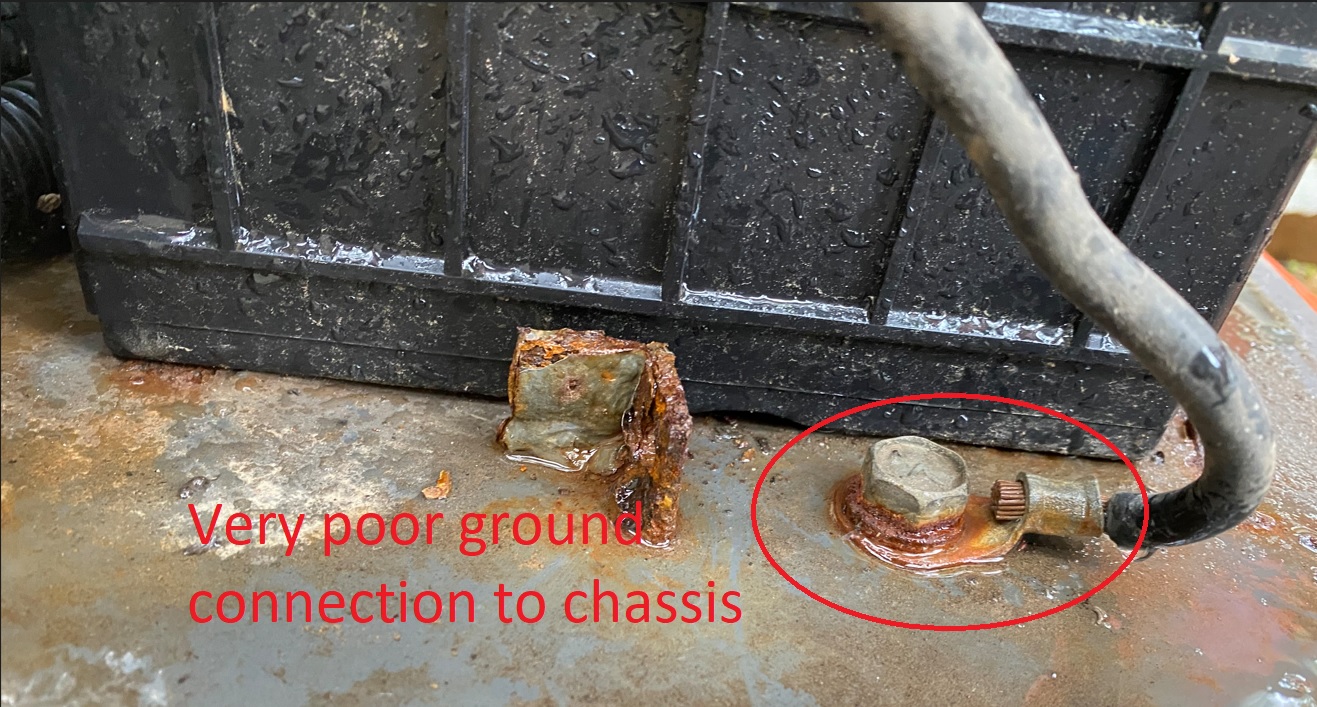

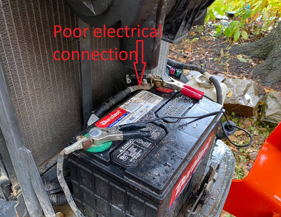

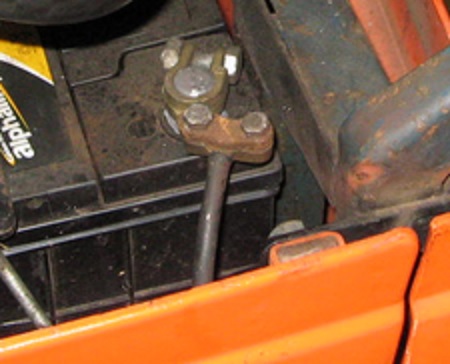

When I read your post, battery and cable issues jump to the top. You say only clicks from the fuel solenoid. That just screams poor electrical supply. Later in your post you talk about jumping the starter.
Could you please post photos of the top of your battery, the cables and finally where the negative cable attaches to the frame.
I am going to post some photos from previous owner problems to give you an idea of what I am suspecting.

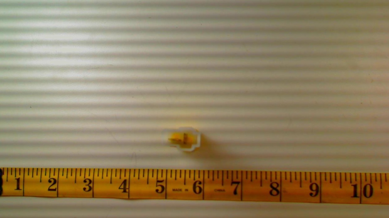

Can you provide the part number of the engine stop solenoid you bought and is it a Kubota part or other.
Does the stop solenoid have 3 electrical terminals or two.

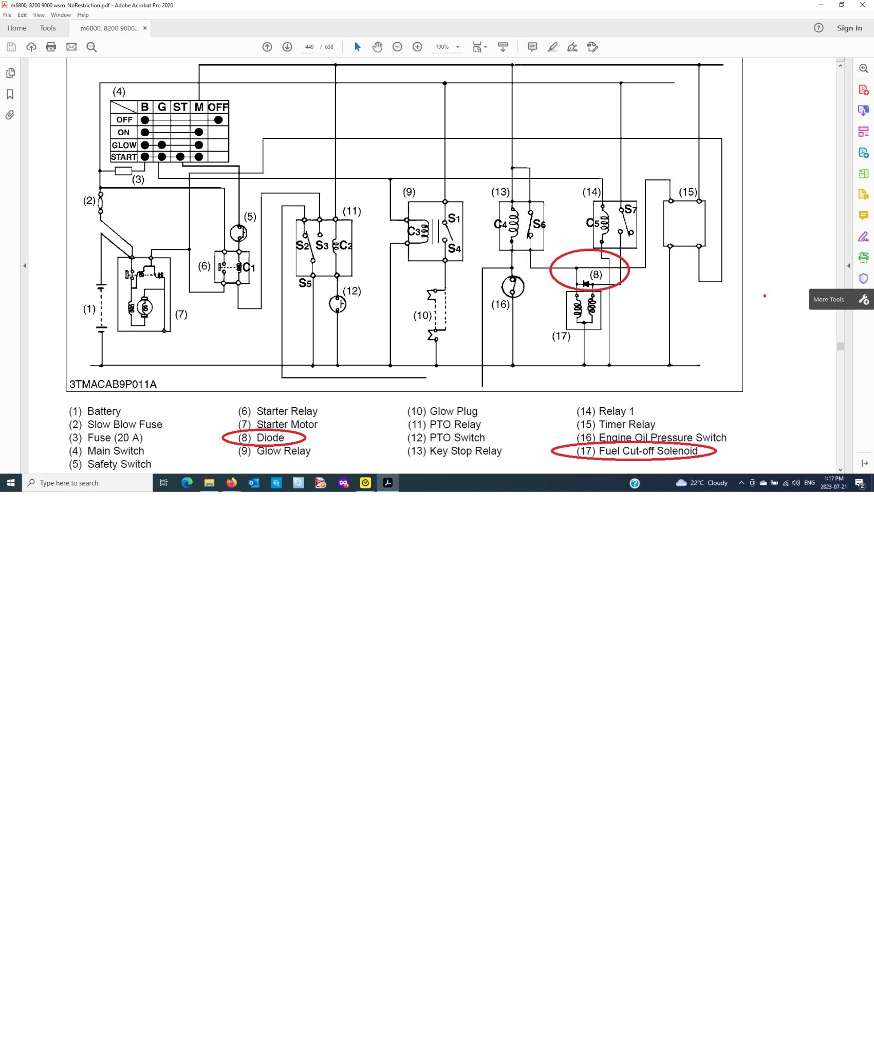

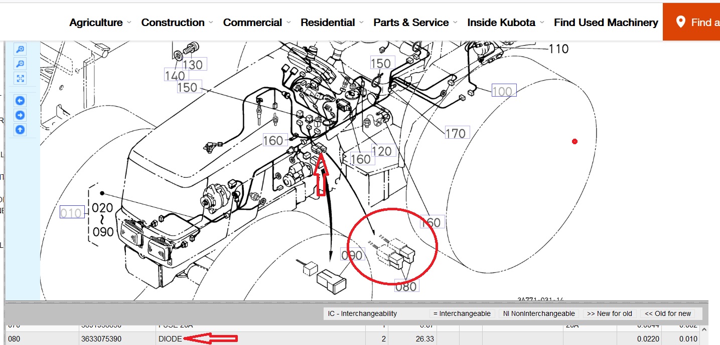

The starter wiring diagram shows a diode between the two stop solenoid terminals. There is also an oil pressure switch tied into the SS.
