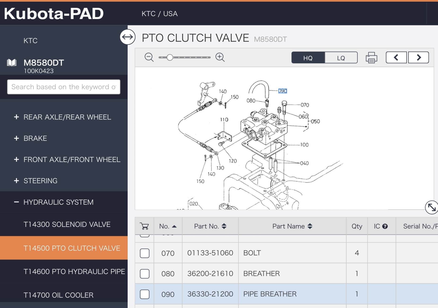

B BradJH New member Lifetime Member Equipment Kubota 8580 Jun 26, 2023 9 0 1 Rockdale TX Jul 22, 2025 #1 Does anyone have or know where to find the location of transmission vents on a M8580 with cab . I'm sure mud daubers have clogged up the vents because the dipstick and drain plug on top of transmission keeps popping out
R Russell King Well-known member Lifetime Member Equipment L185F, Modern Ag Competitor 4’ shredder, Rhino tiller, rear dirt scoop Jun 17, 2012 6,424 2,056 113 Austin, Texas Jul 22, 2025 #2 There is a breather tube attached here (See item #90) Reactions: 1 user
