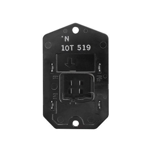

Hey all,
I've seen a few posts about the cabin fan speed issue that's usually a resistor problem. I'm having that right now - good speed on 1,2,3 but 4 (high) is about like 1 or less. So want to change out the resistor but damn, ~ $100 seems ridiculous. Anyone found another resistor (not Kubota) that is the same as OEM but cheaper? Thanks.

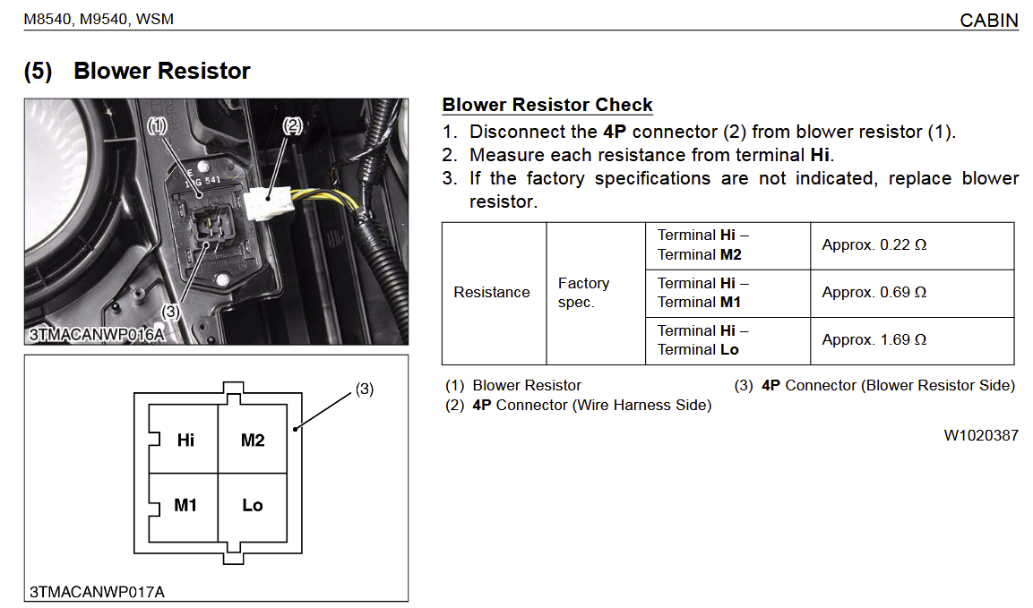

OK, that's not a 'resistor', looks like it has 3 resistors inside of it.
sounds like one of the resistors has opened.
I checked the part online, yup the 'module' sits in the duct, has 3 resistors in it, one of which is open...
now if you had a good DVM, you could check the resistances and bodge a replacement.
I agree $100 (US ) is an obscene price BUT it's the correct part, cheaper than having dinner out though !

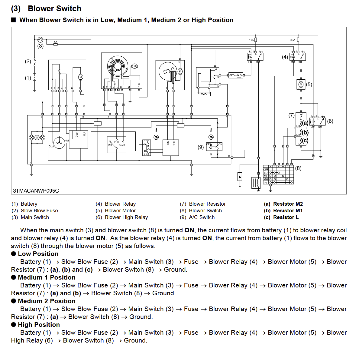

Actually, this sounds like the opposite of a bad resistor. Typically a blower motor resistor pack has high to low resistance for low to high fan speeds. The highest fan speed is usually full battery voltage, no resistor.
Edit- found the M8540 WSM. It is what I suspected- for high speed, the resistor pack is fully bypassed allowing the blower motor full access to ground through the blower high relay.
If you are getting nothing from the blower when it's switched to high, look at either the blower high relay or the switch itself. Don't condemn the component without verifying the wiring and/or connections are still good. You may have corrosion at the connectors or at the grounding point.

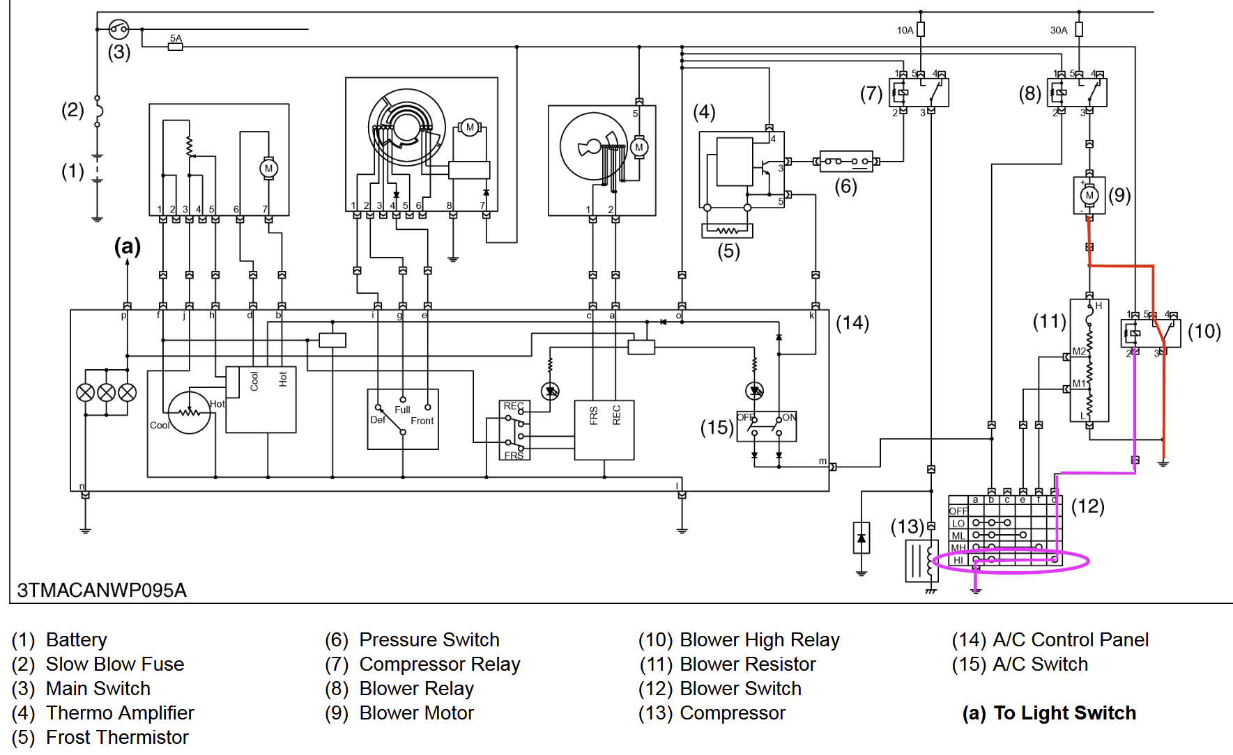

sure helps to see the wiring ! since no 'high', check the 'high blower relay (6)' --- switch (8) connections.
grounding the lower relay terminal should power up the relay and give fan high speed.
should be able to pull the relay, bench test.

Resurrecting an old thread as my blower is acting up again --- blows normal on 1, 2,3 settings but only lightly on high (4). I know this was discussed above but in looking at the service manual I see this message
Functional Check
NOTE
• The relays described here are used same ones so that these
are interchangeable.
Does that mean I could swap one relay for another to test for a bad one?

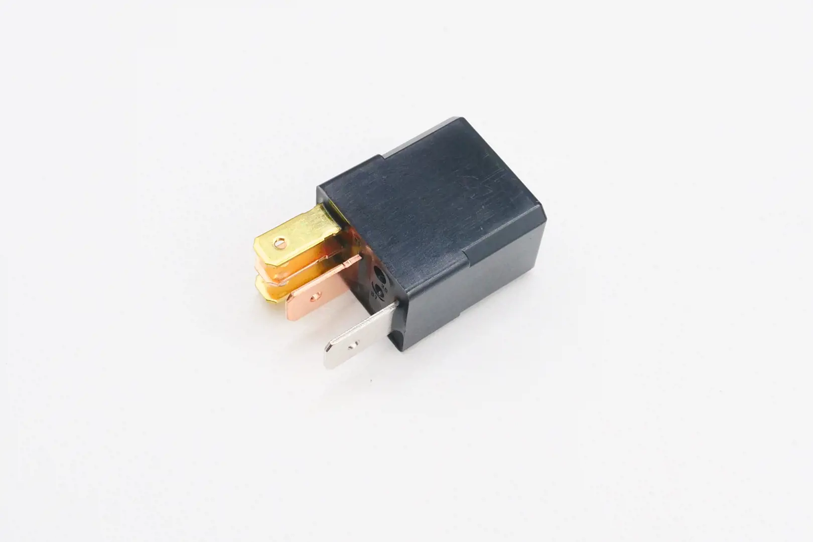

Success. Swapped #12 aux power relay for #11 high blower relay and she blows! Old #11 had some odd corrosion on one of the blades. Ordering a replacement (not what ever the heck that was I posted above.)

I was look at the relay you linked to and it says it's a 35A 12V relay. The Kubota I was looking at is a 20A relay. RD451-54382. Is the Panasonic you linked tthe correct replacement? Did it take a while to get those components since I assume they're shipping from Asia? 1772435788838.png

Digikey is a US company. You should get the parts within a day (a few years ago I got parts from them to Ireland within 24 hours).
And 35A is certainly more promising than the 20A Kubota relay that is burning out.

I was look at the relay you linked to and it says it's a 35A 12V relay. The Kubota I was looking at is a 20A relay. RD451-54382. Is the Panasonic you linked tthe correct replacement? Did it take a while to get those components since I assume they're shipping from Asia? View attachment 170513
Panasonic rates the relay at 20A max continuous carrying current, 35A rated switching.
NAiS (the mfg stamped on the relay) is now Panasonic.
DigiKey is a massive electronics distributor based in Thief River Falls, MN. They show 1,721 pieces in stock so it's coming from MN, not Asia. The company I work for orders many thousands of dollars of parts from DigiKey every year, probably closer to six digits.
