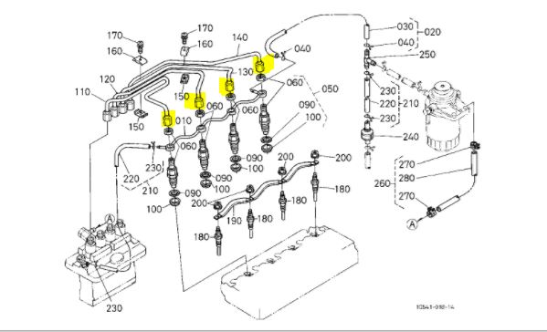

I have an 18 year old M8200 which I think has air in the injector lines. I cleaned the bowl and foolishly didn't refill the bowl with diesel. I've looked at a lot of videos on bleeding the lines but my tractor doesn't look like any of the ones featured in the videos. They're all smaller models. Mine has a primer pump on top of the fuel filter. There are 4 injector lines in a row on the right side of the engine but I suspect this is the injector pump if I'm not mistaken. I loosened the two on the end I could get off and fuel come up. What is the process for correctly bleeding the injectors?

First open the jet start valve on the front of the injection pump crank for a min or so, close valve.
The Crack the lines at the injectors to bleed the air out, crack the lines and crank till you get good fuel with no bubbles.
Tighten lines

Actually you should never fill the bowl with fuel. When you do that the fuel isn't filtered and can stop up your pump or injectors.
It's really easy to prime your system though. Loosen the banjo bolt where the line goes into the injector pump. Then use your primer button on top of the primary filter. When fuel comes out of the banjo bolt tighten it down and start the engine. This is how I do my M9000 and works every time. I've never had to open any injector line to get mine to crank.
