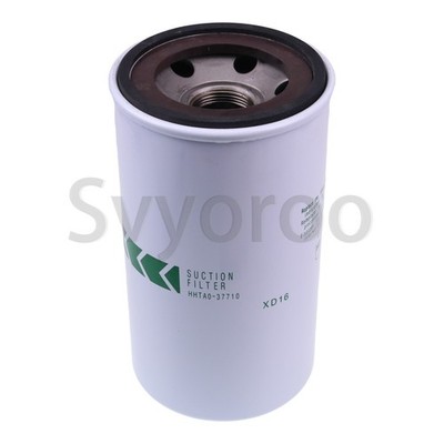

Long story short, the hydraulic filter is non typical nor labeled. I've exhausted the local kubota Supplier, wix and Amazon. The filter does not match any thing listed. It's tread is either 1 1/4 or m32 which is not normal. There has been no modifications or upgrades. HELP 1994 M8030DT

There was two filter setups for that model.
One used a small filter, one used a large filter.
The original large filter number was 33740-82630
That number superseded to H3380-82630

294
Herald Calif.
