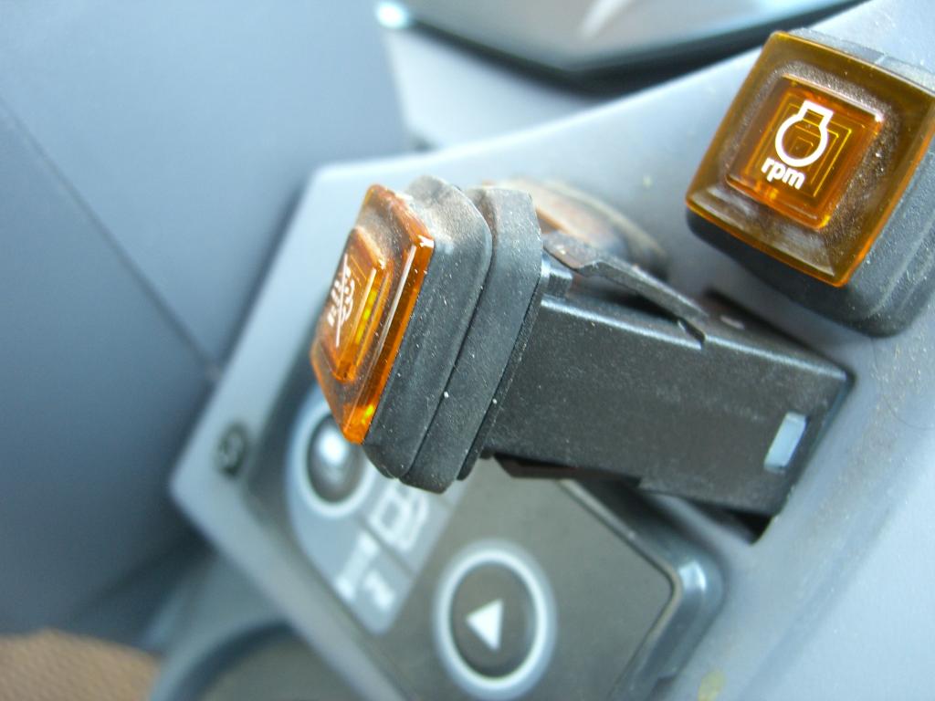

Does anyone have any experience changing out the DPF switch or the DPF Inhibit switch or for that matter any of the push button switches on the dash? The lamp in the DPF switch quit working and I was wanting to repair it. I just need to know how to get it out of the dash. Thanks Bruce

You can Pull them more or less straight out. Wiggle a bit up and down and it'll come out.
The pic is from my M4D-071, but should be the same.

they don't always wiggle free. Most of them you have to reach under the switch and pinch the two tabs down a little with ya fingers.
