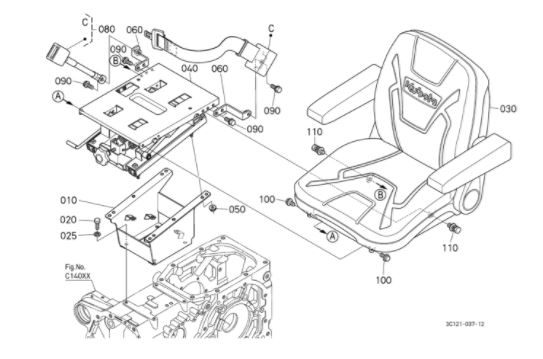

We just took delivery of our new M7060 and the seat sits so low its not comfortable to use clutch and brakes. I can't be teh only one who has had this problem! I'm 6'1" but have shorter legs and long body, I cant imagine having long legs with this machine!
Anyway, has anyone came up with a solution for this? Looks like you could put some spacers in, but the slant of the seat base has me worried about pushing further forward, which also seems like its pretty tight.

If you need to raise it you need to raise the base P/N 10, held to the top of the Rear end with 4 bolts.
