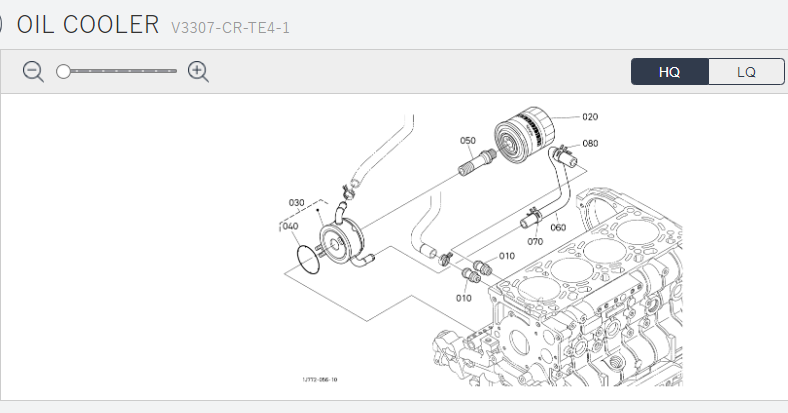

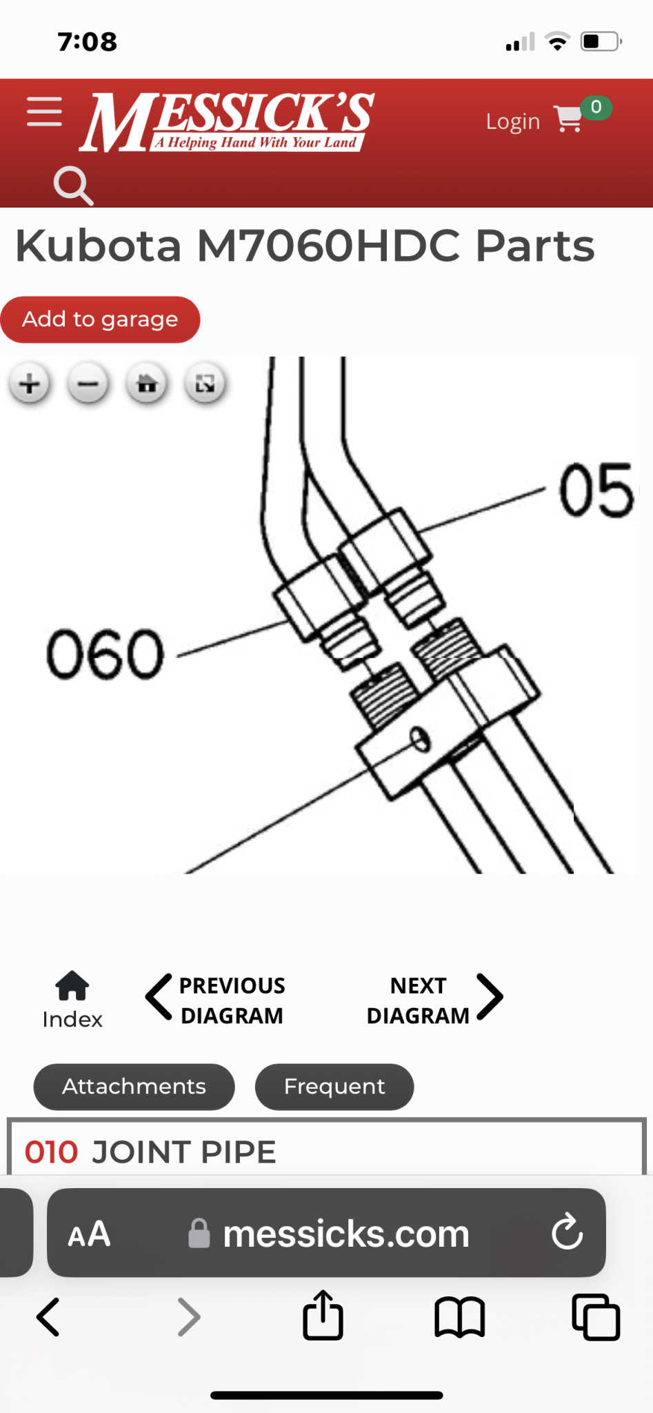

H HenryHolcombe New member Equipment Kubota m5140 M7060hdc Jun 13, 2023 10 3 3 NC Sep 2, 2023 #3 North Idaho Wolfman said: You have to know it's kind of hard for us to tell you where it's leaking without any details or pictures. The oil cooler is pretty simple. View attachment 110567 Click to expand... I meant to say oil cooler for hydraulics. Leak is coming out of the top of the nut. Is there a o ring at connection? Attachments 15E65993-F4DE-4D7D-A0D4-826501B6F74D.png 548.6 KB Views: 69
North Idaho Wolfman Moderator Staff member Lifetime Member Equipment L3450DT-GST, Woods FEL, B7100 HSD, FEL, 60" SB, 743 Bobcat with V2203, and more Jun 9, 2013 29,852 6,058 113 Sandpoint, ID Sep 2, 2023 #4 HenryHolcombe said: I meant to say oil cooler for hydraulics. Leak is coming out of the top of the nut. Is there a o ring at connection? Click to expand... No they are flare fittings, just loosen and retighten fittings.
