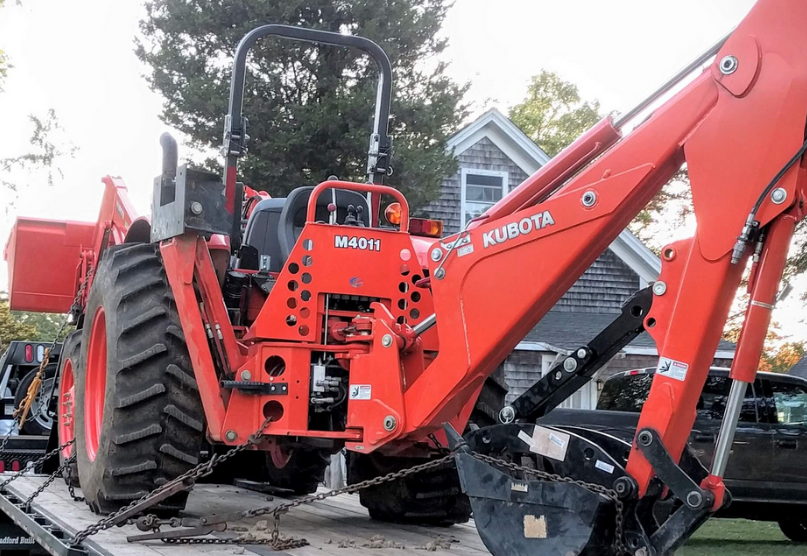

I think it's the M4509, or at least that's one model. You'll need a sub frame too right. I know that Kubota no longer offers/makes backhoes for the M7060/M6060 because I enquired at the local dealer after I picked up the M6060. It was crazy expensive or would have been had the not been discontinued.
See this post.

interesting... at least some US dealers do? I be no expert so don't know why Kubota Canada doesn't. Maybe discontinued?? but used ones still for sale at least if OP really wants one.
and Messicks carries parts
The owner who is considering the one shown lives in Canada so acquiring the mounting frame may be a challenge
