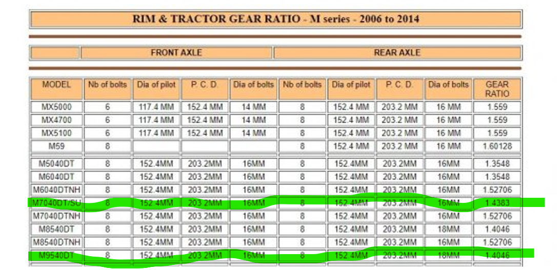

I guess you know the drill then. Kubota does have wheel data by model so you might be able to find what you need that way. @whitetiger is pretty helpful with that sort of information.
If not seems like you need to find someone with the M9000 wheel and a tape measure.

Well who ever put those tires and rims on it risked doing damage to the drive train as the ratio is wrong.
That's why they are not listed as a option on the M7040 builds.
The front rims for the M9540 ( same era and build time as the M7040 ) does fit it, oddly enough the rear rims shouldn't be used as they need 18mm bolts.
The front and rear rims from the M9000 do fit it.
So yes the 35515-24130 will fit it.

Could I get a clean copy of that? I already have it for the L series.
