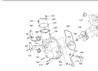

Here is a picture of the photo in the repair manual of the accelerator cable connected to the throttle. If I disconnect the cable by removing the cotter pin, what else do I need to remove/undo to be able to lubricate the cable.
Not sure what parts at the end of the cable need to come off?
Also don't want to change the cable settings.
Thanks for your input.
PS I have seen those motorcycle cable lubers. See attached photo.
Just not sure what to remove to use something like this.
33,992
9,196
Your problem is not the cable that runs to the injection pump as the foot throttle works fine, your problem is in the rear cable that runs from the hand throttle to the foot throttle. ;)
