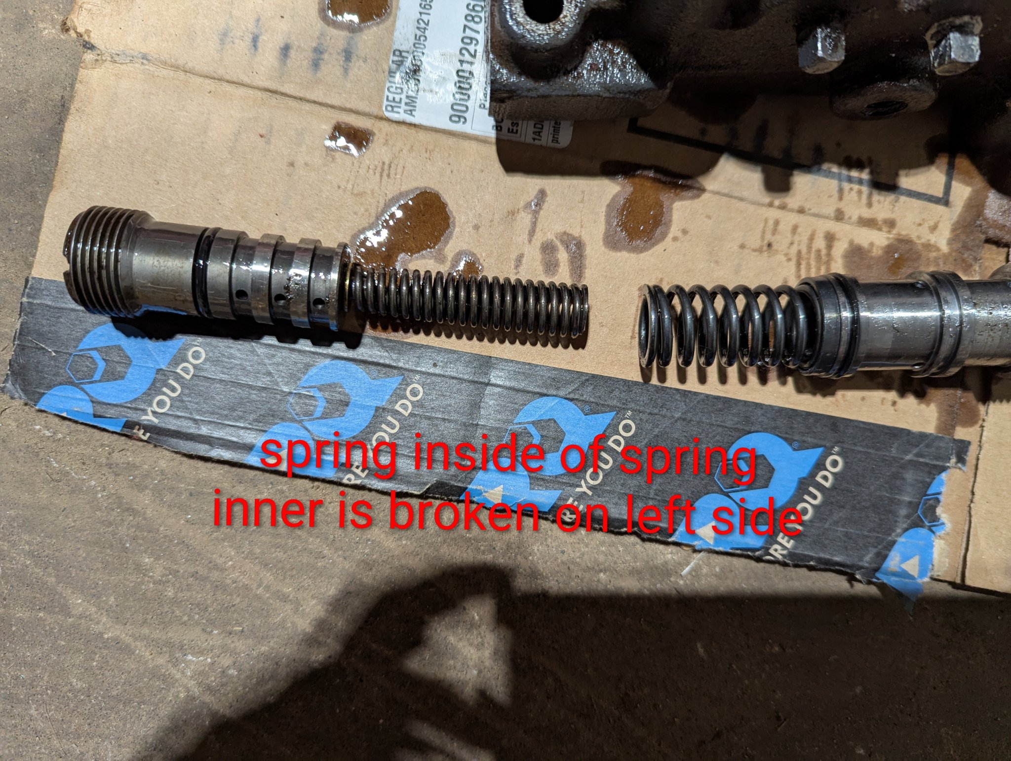

I disassembled the shuttle valve, and I did find a broken spring. My best guess looking at wsm and hydraulic diagrams, is it was the modulation valve part.

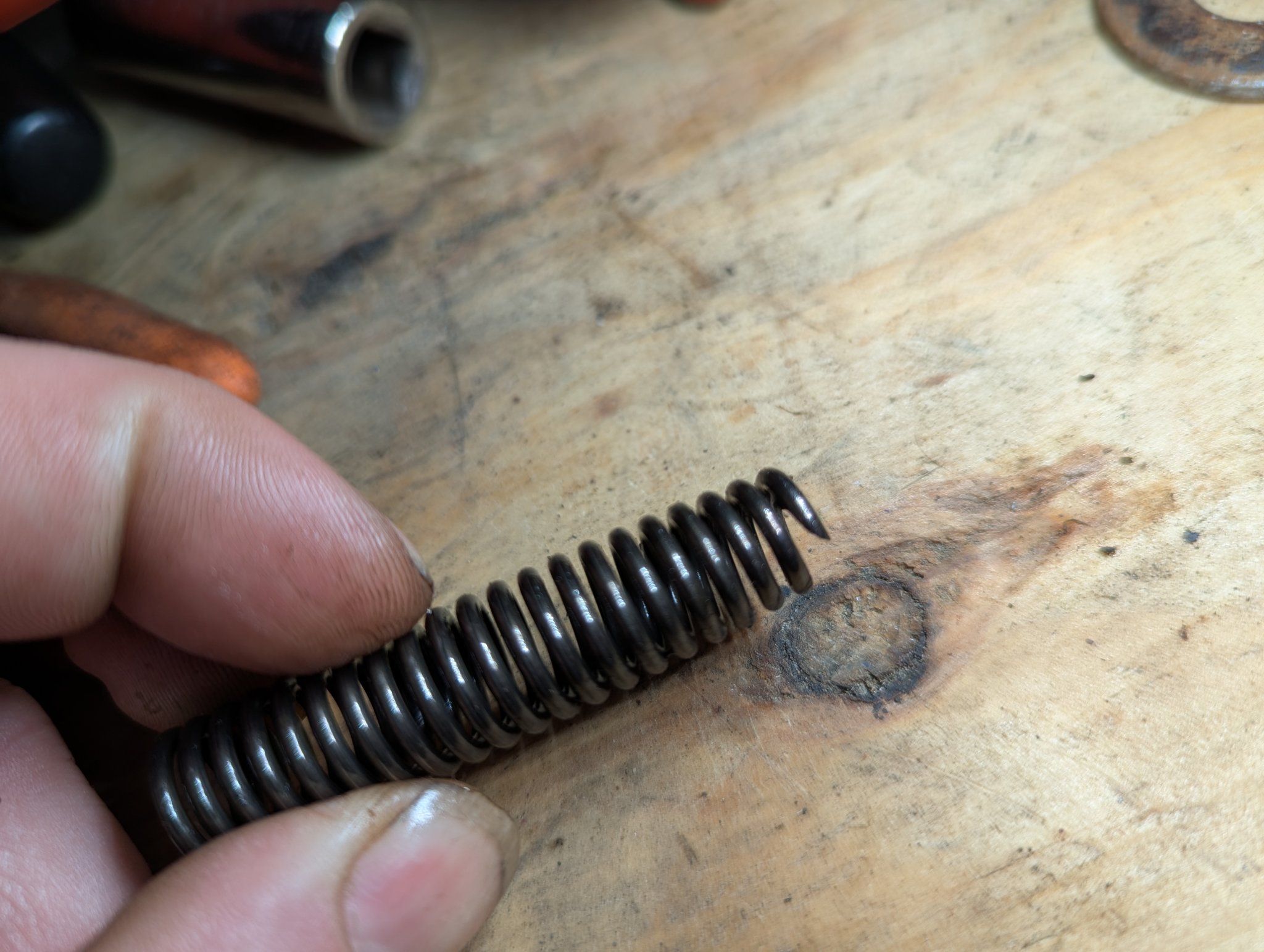

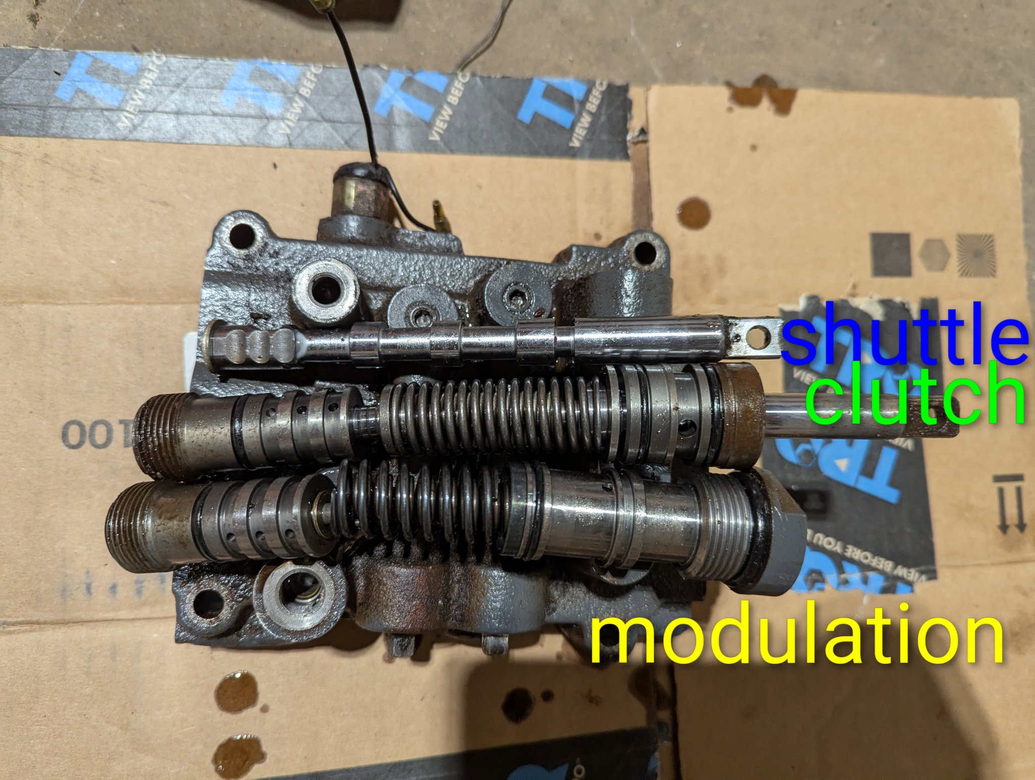

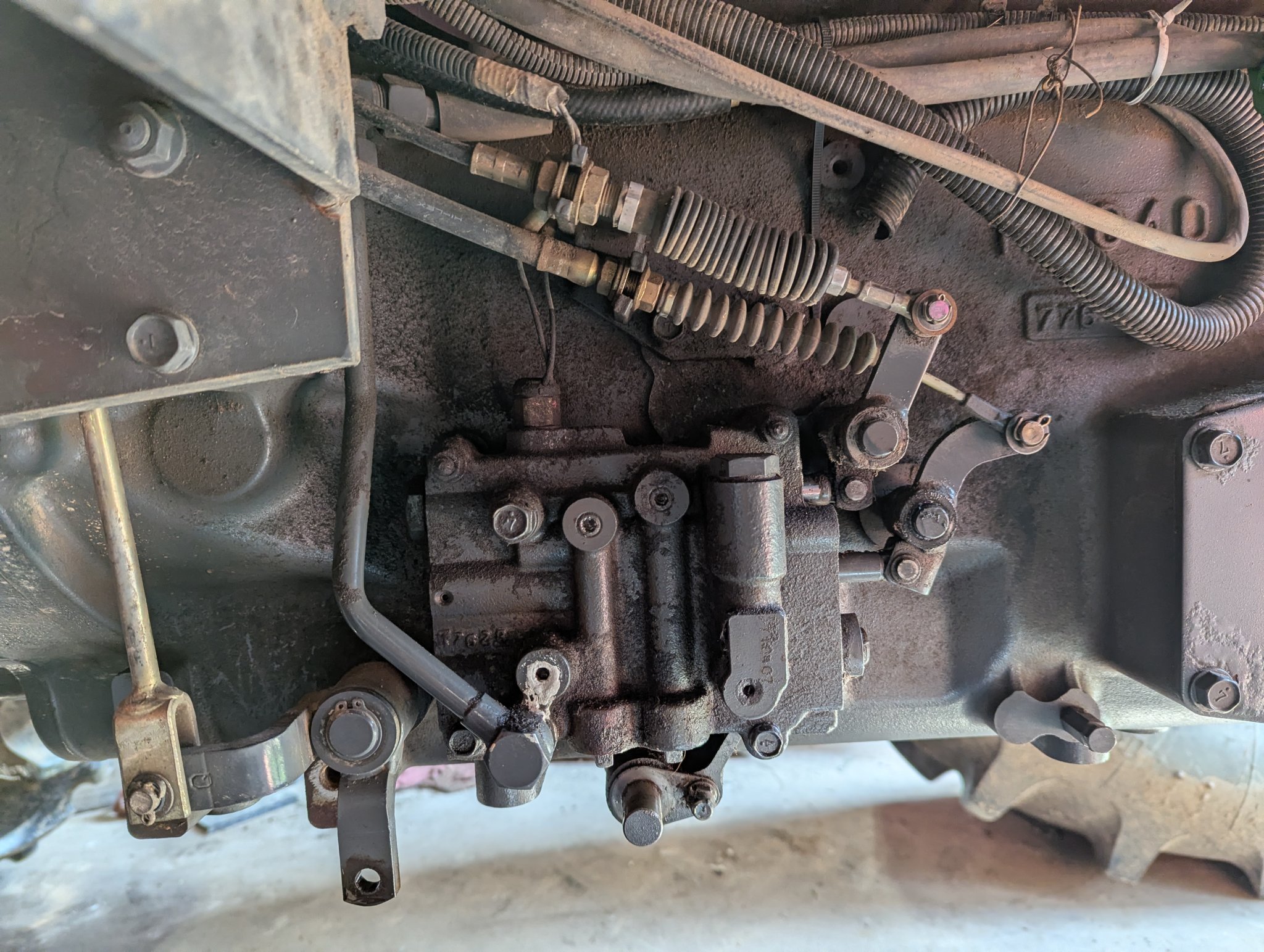

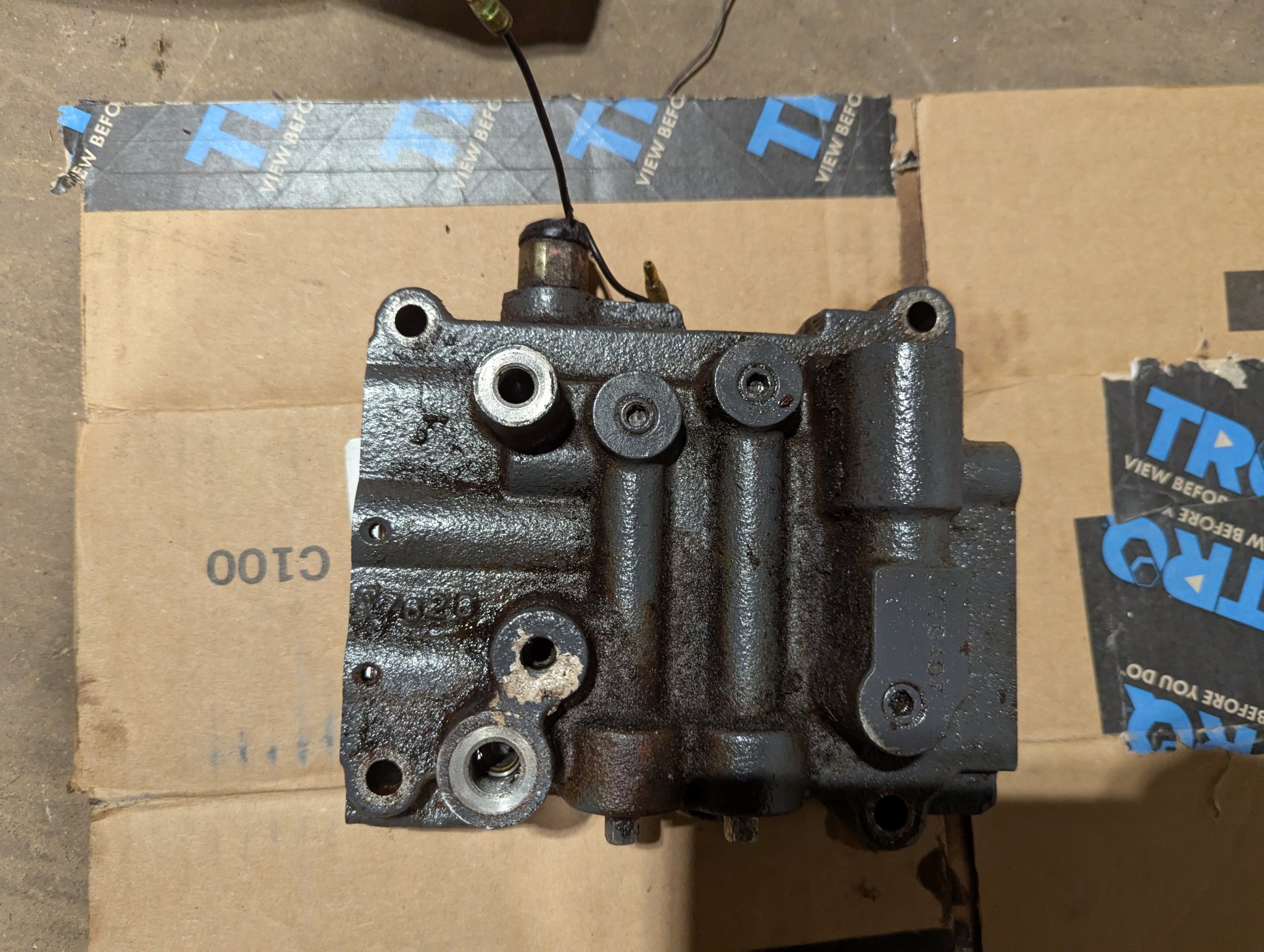

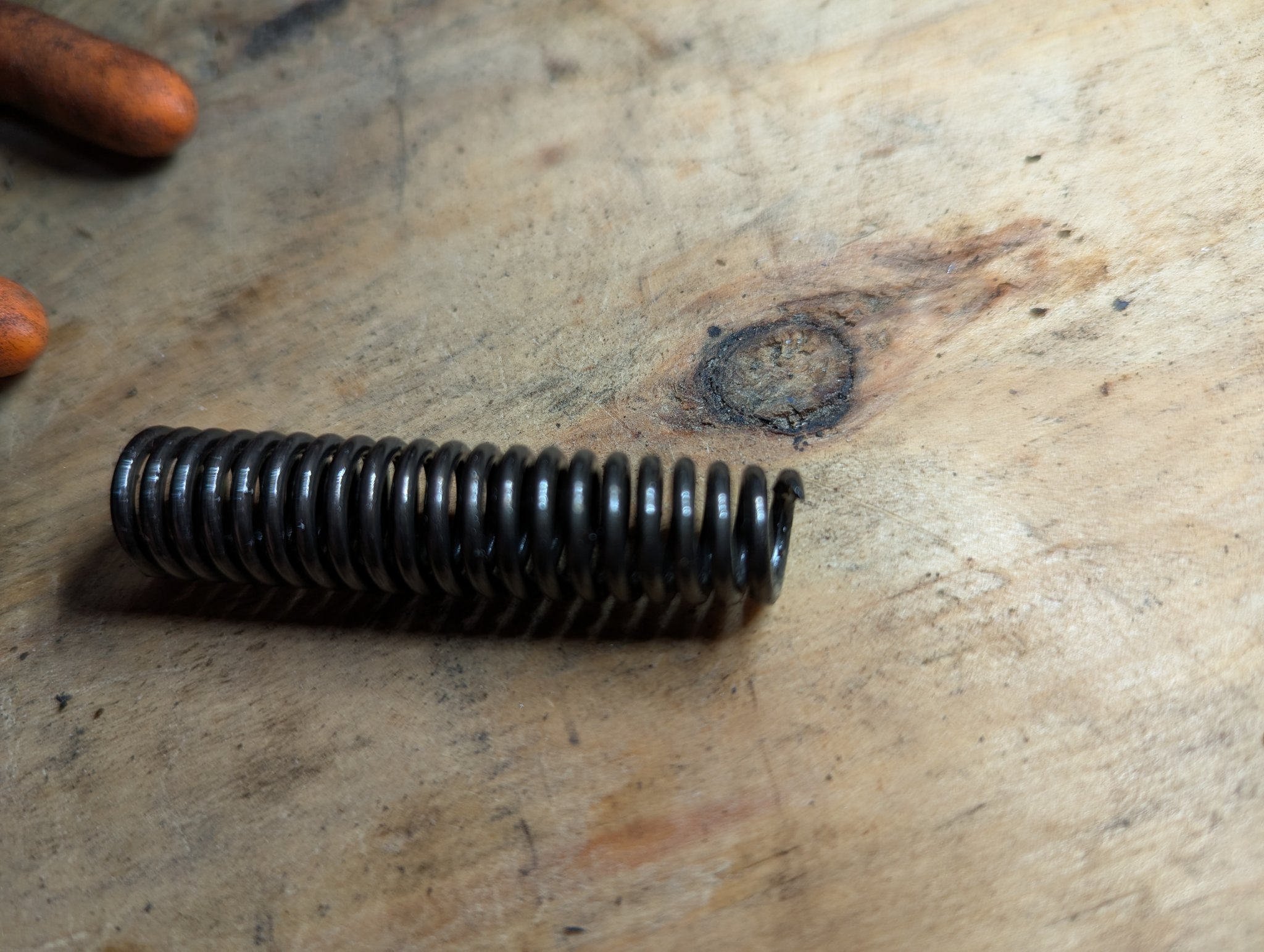

Some pictures.
The spring is missing about a coil and a half. I had the piece but lost it on my bench somewhere. I suspect it was either jammed or no longer putting the proper pressure on the left most piece, which is a type of spool.
The picture installed is as I was in process of removing. The white goop is excessive thread sealant on test port.
