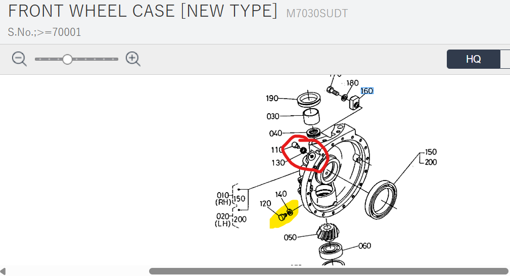

The illustrations in my manuals are very poor. My front hub looks different from the illustration. There is a plug in the bottom and a plug half way (14mm) up and it looks like a plug surrounded by a large sq. nut higher up. I took the 14 mm plug out and had gear oil flowing out. It appears my ozzing is above the bevel gear and that oil comes from the axel. I find a plug about half way up on the axel housing on left side of tactor, is that the fill and check oil plug?

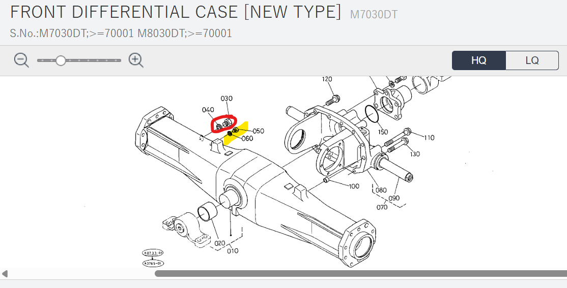

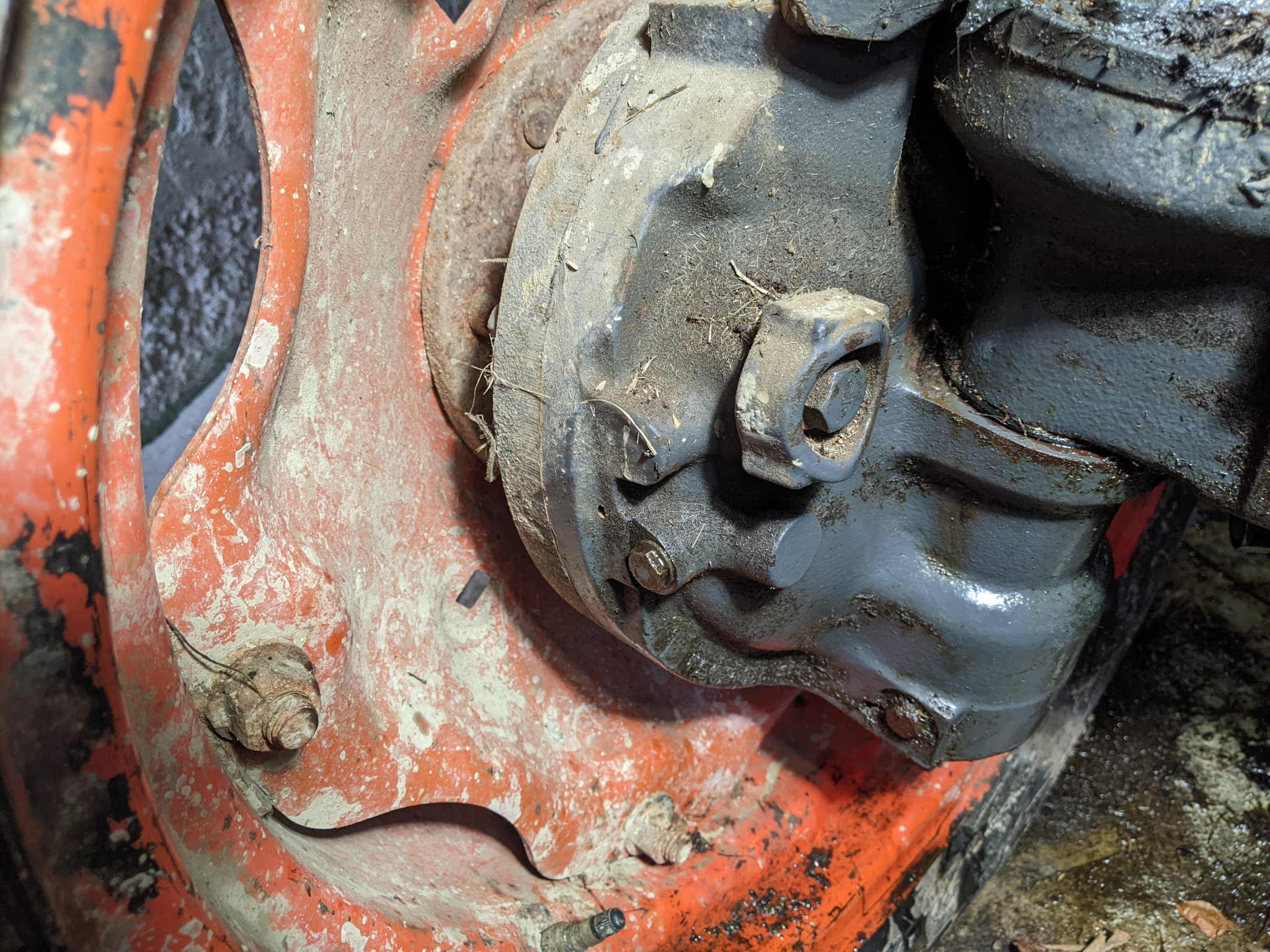

I found the axel was low on oil and added 75-90 gear oil. I am not using the tractor much so will see how much oil it is leaking. Do I dare use corn head grease in that front axle in an attempt to stop the oozing? I have attached a picture, it shows the drain plug and the fill/level plug. what is the plug inside the nut in the middle of the picture? You can also see the seal that is oozing. The second picture shows the axle fill/level plug, that's where I would put the corn head grease.
