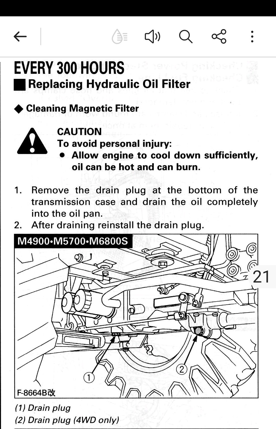

G Gus1957 Member Premium Member Equipment M6800, L2501 TLB, BX2370 Dec 17, 2023 48 36 18 Cobleskill NY Thursday at 4:29 AM #1 https://shop.kubotausa.com/oemparts/cl/kub/60a32a3187a8661054394f58/m6800-m6800s-hydraulic-system-parts?lid=6215e66b7367254ceca375a8 Can't find it in these schematics Can a dealer power flush the entire hydraulic system? TY
TheOldHokie Well-known member Lifetime Member Equipment L3901/LA525, G2160/RCK60, G2460/RCK60 Apr 6, 2021 10,764 5,879 113 Myersville, MD windyridgefarm.us Thursday at 5:13 AM #2 What makes you think there is one? There are two spin-on filters on the suction line. If you want a "power flush" fill with cheap oil, remove any power beyond line, start engine and catch flushed oil in a big bucket. Dont run it once empty. Dan
