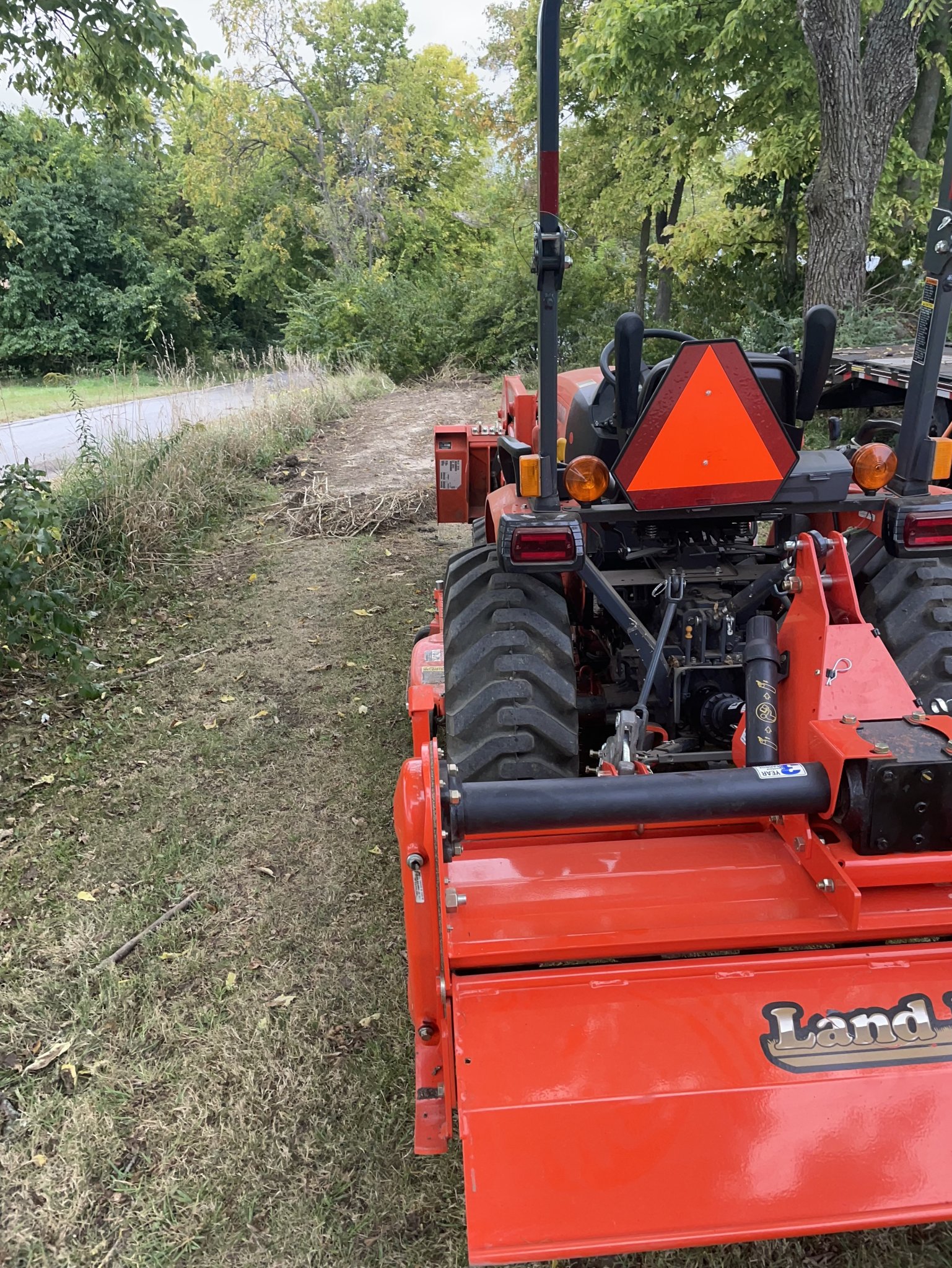

I run a 5' tiller, offset behind my 6' wide tractor. the left tire track becomes the pathway for the gardener to 'do her thing'.
No way I'd pay $1,000 MORE for less 'seat time' !!
