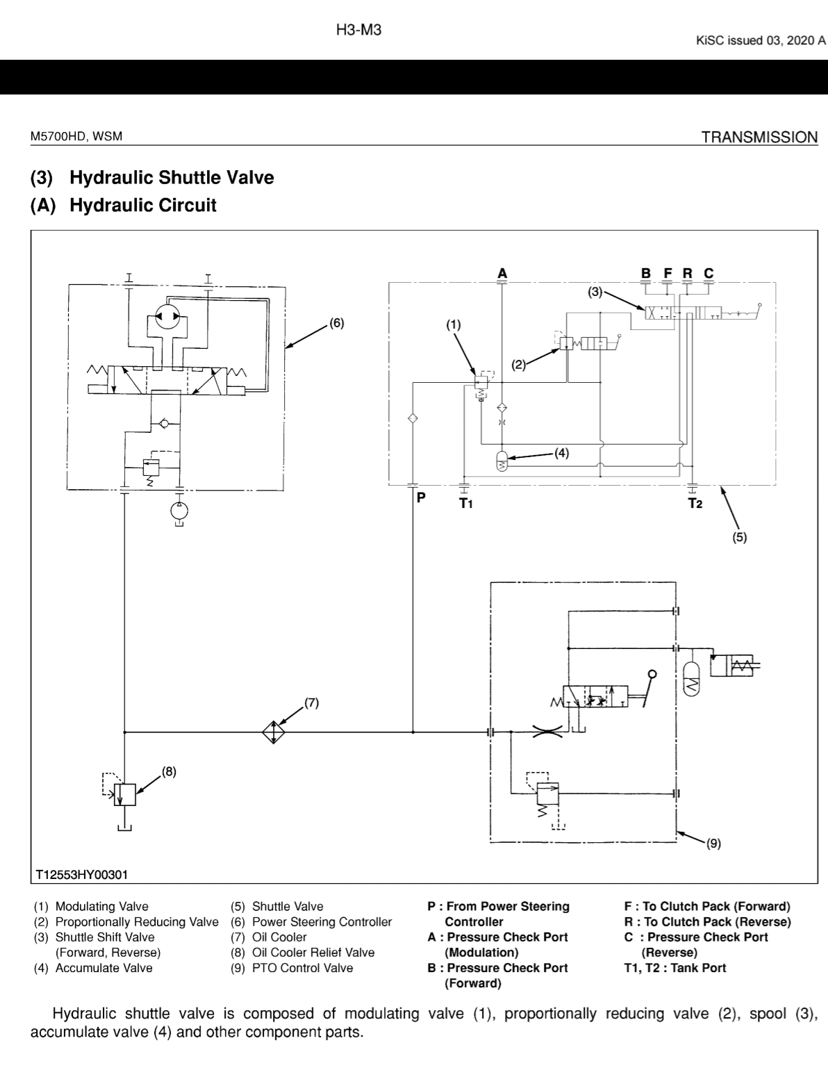

Here's the steering/shuttle diagram
I may have missed it, but I don't recall a troubleshooting guide in the clutch/transmission sections. So, I'd start by checking the modulating pressure at the A test port. With the transmission in N and the clutch engaged, it looks like the pressure should be 600+ psi. Fully disengaged, it should be minimal.
Much less than 600 would indicate a problem upstream, cooler, cooler relief, steering box possibly. Let us know what you measure.

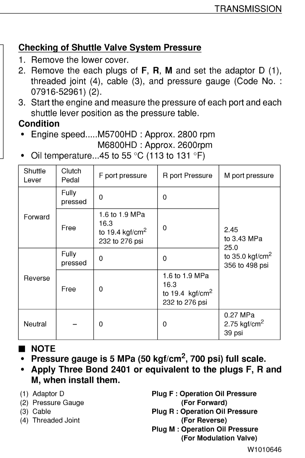

EDIT, I missed that the shuttle shift bleeds off the modulator in neutral, so you won't see 600psi. Here's the test pressures, M port in the chart corresponds to the A port on the hydraulic diagram.

Thank you for the response. I have the WSM for the tractor but the section for the shuttle valve sections could be better. Last season the tractor started showing some issues once it was running for a while. Lose of motion, but seemed to have better reverse than forward if that makes sense. Reverse still engaged fully and you could push down on the brakes and bog down the engine. However while going forward you could push the brake and would "disconnect" the hyds but never bog down the engine. But you could push the clutch in and release and it would start to move forward again. Put it off and serviced the unit hoping it would resolve this issue. It did not lol. Which lead me down to buy the WSM and preform the shuttle vavle pressure test. Test failed on the F port, disassembled the valve, found damaged components, replaced with new valve, now hyds lock in forward and bog down engine same as reverse. But still have a funky pressure issue at engagement once hot.
As far as test procedure.....
F port - fully pressed 0 psi
- free 265 psi
R port - fully pressed 0 psi
- free 265 psi
M port - 360 psi Forward and Reverse
"seem to build pressure slower then they should"
M port in neutral is 0 psi or at least not showing up on my gauge 0-1000psi
The kicker is when turning the steering wheel hard, once hot, and taking off in gear with the pedal released. No pressure will show on the M port until you let go of the steering wheel and let it find a natural state. Pressure slowly will build and you can feel the clutch packs engage.

Well, the pressures check out, indicating the cooler relief and PTO clutch relief valves are working correctly. I've tried to come up with a scenario that the steering controller could be at fault, but I don't think so.
It seems that you just don't have enough flow to supply the clutch. This could be caused by
1 Weak/worn pump - apparently you have sufficient flow for the steering to work correctly, so this is low probability. But considering the PITA to correct 2, it might be worth testing the pump first.
2 Internal leakage between the shuttle valve and the clutches, including the clutch packs themselves. As @North Idaho Wolfman said, there are seal rings to seal the passages to the clutches. If the internal leakage is too much, there won't be enough pressure left to apply the clutches.

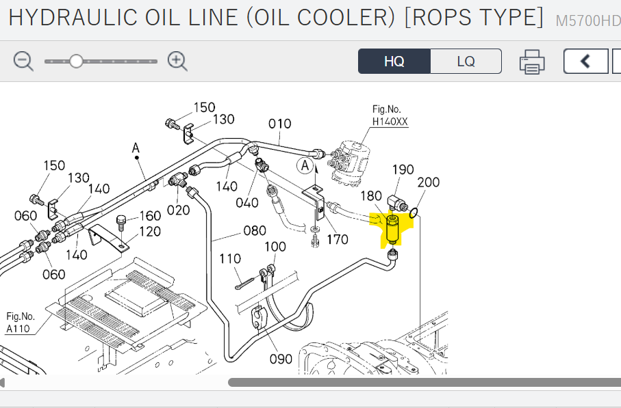

Thank yall for the responses. We are running kubotas SUDT only. The steering isn't what you would say correct 100%. Failed to mention that on the original post. At low ideal once hot does seem to take more effort to turn those tires at a dead stop. And that's when you can turn the wheel and get no flow into the M port of the shuttle valve. Once releasing the steerting wheel pressure slowly returns and tractor will start to move. Going to pull that relief valve off first give it a good visual inspection. If we don't see anything crazy probably will go get the hydraulic pump tested and inspected. Trying to do everything externally first. Please let me know y'all's thoughts.

You have a lot of qualified help here, and not going against anything mentioned so far, my next suspect would be the steering pump. Shuttle and PTO valves are downstream of the steering valve. Steering relief valve is no doubt built into the steering valve, so whatever goes over relief still goes downstream to those other circuits. As you are explaining this my impression is when the steering is loaded to it's relief point nothing is going downstream. As such, PTO probably stops as well as the shuttle clutch pack. That would indicate the pump isn't supplying enough flow (and/or pressure) to open the steering relief.
Questionable condition of shuttle clutch packs not withstanding, I see the lack of proper steering as the point to address first. Once that's resolved see what remains of the other issues.
