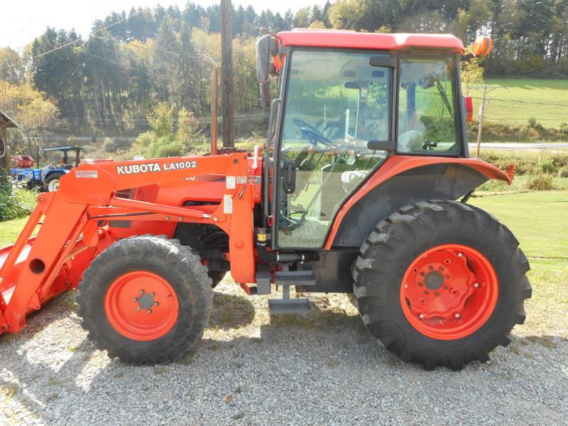

Update
I did buy the tractor, should be delivered next week. Tractor had new rear tires installed at a Kubota dealer as well as filters when it was traded in, ( I actually purchased it from an equipment dealer) Tractor seemed in good shape inside and out and paint not faded, i'm thinking it was likely kept indoors. Motor started easily on a low 20 degree morning when I went to look at it. Everything seemed to work as it should. Looking forward to getting it in the driveway and putting it to use.
Bulldog
M 9000 DTC, L 3000 DT
Mar 30, 2010
5,434
76
Rocky Face, Georgia
Re: Update
Nice looking tractor. I would love one that size for a middle tractor. Looks like original owner spent some extra $$$. I see it has right side mirror and rear wiper, both are options. Unless it was just removed I would ask them about the SMV sign, it came with one from the factory on the left fender.
My guess from the looks of it you found a great machine. It looks almost like a brand new one. Happy tractoring.
