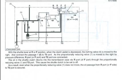

Oh, sorry, I didn't know you'd already tried stepping the shift. There is a general WSM PDF here on major components. A discussion on the 3A051-23803 shuttle valve starts on page 21.
The shuttle valve assembly contains several valves. (no dry clutch disk on hyd shuttle model) The clutch pedal connects to the main variable reducing valve. When the pedal is pressed down, pressure to both clutch packs drops to zero. Other shift management functions are bypassed. The issue could be in the accumulator, one of the modulating valves, the shuttle spool, or elsewhere.
Luckily the clutch pedal valve still works so the tractor is usable as-is until you get more opinions. I'd recommend using it as-is and see if the symptoms change or even go away.
Question: If the clutch pedal is slowly lifted with the lever in F or R is engagement gradual as expected? or is there still an abrupt change ?

Testing clutch pedal behavior may help confirm whether the issue is in the shuttle valve or perhaps somewhere else. If it still grabs it might point to a problem in the clutch pack (likely would be different for Forward and Reverse). When testing, see if there's a difference letting the pedal up slowly, or at normal quickness like before this came up.
