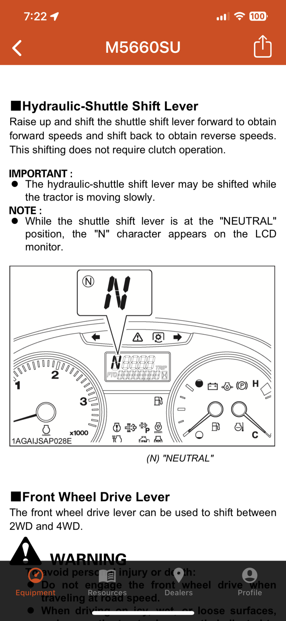

I drove the M5660 yesterday. The salesman said use clutch when using the shuttle shift. Sales brochure said no clutch. I haven’t seen the manual yet. What’s the correct way to use the shuttle shift?

I don’t clutch when moving around in low range and low RPM; however, when mowing or other higher RPM and/or high range, I use the clutch when shifting F & R.
Now what defines slowly, is anyone’s guess. HaHa!

Thank you very much Sir. Where did you find the digital version of the operator’s manual?

My Kubota App. I keep up with all maintenance and materials there. Easy to use.

The shuttle shift operates the clutch pack hydraulically so there's no need to depress the clutch pedal when changing direction. I only use the clutch pedal when shifting gears (within a range) or when backing up to an implement for more control.
I do allow the rpm to drop to near idle when shifting the shuttle between F and R. Engaging the clutch via the shuttle shift or via the clutch pedal with the rpm significantly off idle isn't a good idea. We're not trying to launch these tractors off the line like a drag race.

I have an M4. For F>R shifting, I never use the clutch. Sometimes I do shifting F>R. The limit for me is in higher gears like 5L, 6L the electronic clutch let-off is pretty abrupt and will launch you backwards. I dont think its a problem for the system, it's just a quick launch backwards and is unsettling acceleration. Going R>F is less abrupt for some reason, or maybe stabilized by the weight of the FEL. It could be a mental thing...like fear of flying backwards into something.
