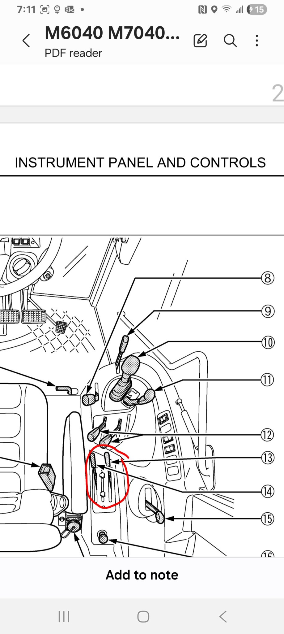

Please post a picture of the draft and position control lever positions.

Which lever are you using to raise and lowet the 3pt?

History is not really relevant. The only way the 3pt lever can work in reverse is if the internal linkage is moving in reverse. Position control moves it one way and draft moves it the opposite.
