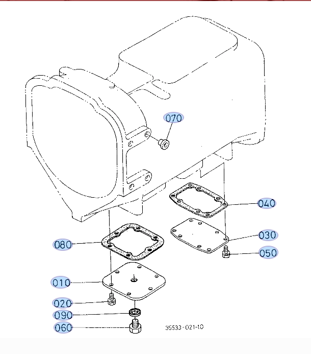

Hi all, first time poster. I have an old M5030 and I love it. I had a guy replace the clutch(twice actually, as he failed the first time) and now I have an odd issues. One issue is when I'm running it, hydraulic oil comes out the breather tubes clutch housing. A lot of oil to where it leaves a snail trail. Maybe it's not related to the clutch replacement, but I thought it worth mentioning. I'm hoping someone has an idea. If not, I have to pull off the loader to get at the inspection plates.

You're getting oil out of the breather tube hoses on top of the clutch housing? If that's the case it's probably not an oil foaming issue. More likely oil leaking into the clutch housing from the transmission, then getting slung around by the flywheel and forced out the vent tube.
At least that's my take on it. There should be no pressure in the clutch housing. Is there any sign of oil dripping out the bottom, or is there maybe a plug down there? The parts list shows vent tubes on top but no plugs or drain vents on the bottom.
There is a plug down there I'm pretty sure. I did drain it when I changed fluid but I dont remember how much came out, but I feel like it was a good amount, whatever that means.

I pulled the drain plug on the housing in the picture above, and it seems like motor oil and around 3.5 quarts. So I'm thinking rear main seal, which was supposed to be replaced with the guy replaced the clutch. Maybe a seal from transmission side as well. I should have just done the job myself to begin with. This will be fun.
