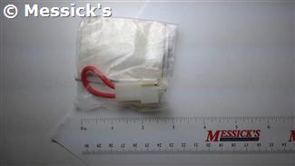

Could you post a picture of what you are calling a Fusible link?

I'm hardly knowledge about electrical circuits, so I may be muddying up the water. This is what i'm calling a fusible link. It was wired into the starter or something right around the starter...I've never lost power to the tractor.

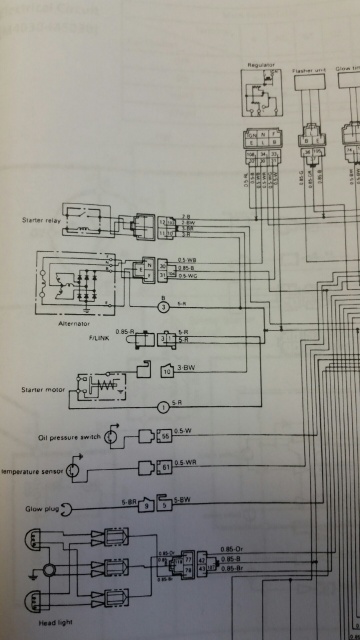

It does have some wiring diagrams/schematics, but I'm not certain how to interpret it. From the diagram, it looks like the fusible link is wired into the red (hot?) wire on the starter and to the red coming from either the alternator or starter relay. Attached is a picture of the diagram.

It is possible what you are posting is a slow blow fuse which is somewhat like a fusible link.

Your image was no better but I enlarged it enough to see that there is s special type of fusible link that looks like the one your posted a picture of earlier.
I have marked it with a red arrow.
It appears to be serving critical circuits so should be replaced.
I would need a better picture of the fusible link you posted to determine if the loop of wire is the fusible link and there is a plug in connection to install it into the circuit.
