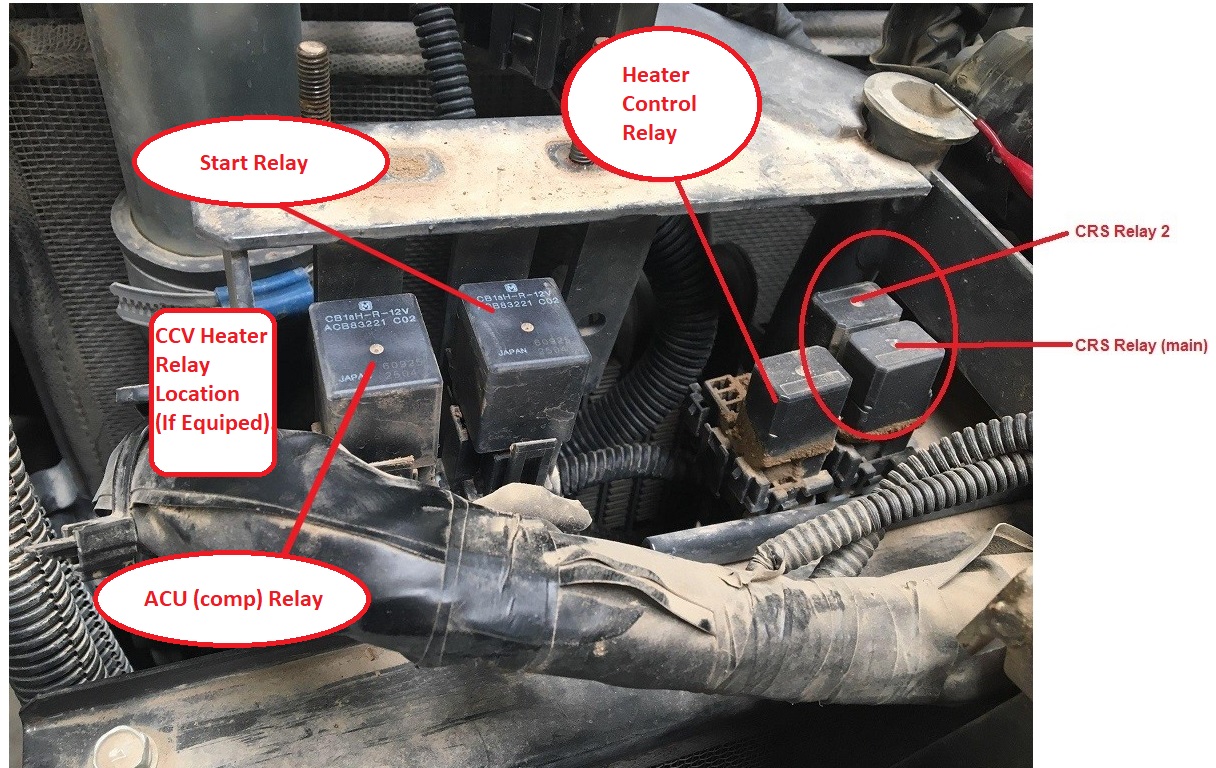

During operation, the aftertreatment system may intermittently become disabled, PM level raise, and multiple DTC codes are present.
With intermittent issues, poor electrical connections or contacts are commonly the cause of the issue. One area to check first is the CRS (main), CRS 2, and ACU relays located under the hood in the engine compartment. In addition to regular relay testing, inspect the relays for corrosion, moisture, damage, or other foreign material that could lead to high resistance between the relay contacts and the connector. Secondly inspect the J/C connectors located directly behind and between the ECU and the ACU.
Note: The ACU relay is also referred to as the comp relay (40A) in the wiring schematic or the compressor relay on page 10-138 of the workshop manual.
Yea I checked all of that and got a pin diagram from dealer. But without rest of manual it couldn't tell me a whole lot, it kind of pointed me to exact pins for ground and power from battery. And since those checked out and nothing was badly coroded or chewed up, I suggested customer take it to dealership so they can hook it up and see if it is bad. This is first system I have messed with that has the ACU, I worked at agco dealer for 10 years and Thier scr systems are all in one module they call the ecu. So hopefully come back from Holliday and get an answer
