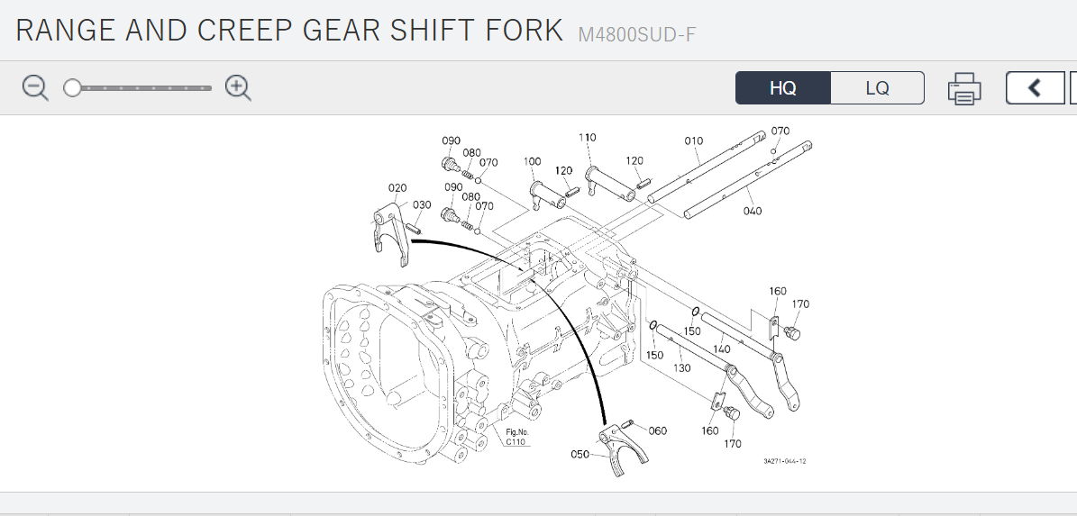

P Paulm4800 New member Equipment M4800 May 16, 2025 1 0 1 Biloxi Yesterday at 6:51 PM #1 Lost creep and reverse but high gear is still working. Verified shaft into housing is turning. Pulled trans cover and shaft in trans is not. Think its the shift fork or pin. Does anyone have a m4800 service manual to show how to access those parts?
North Idaho Wolfman Moderator Staff member Lifetime Member Equipment L3450DT-GST, Woods FEL, B7100 HSD, FEL, 60" SB, 743 Bobcat with V2203, and more Jun 9, 2013 32,851 8,337 113 Sandpoint, ID Yesterday at 9:34 PM #2 Check the roll pins:
