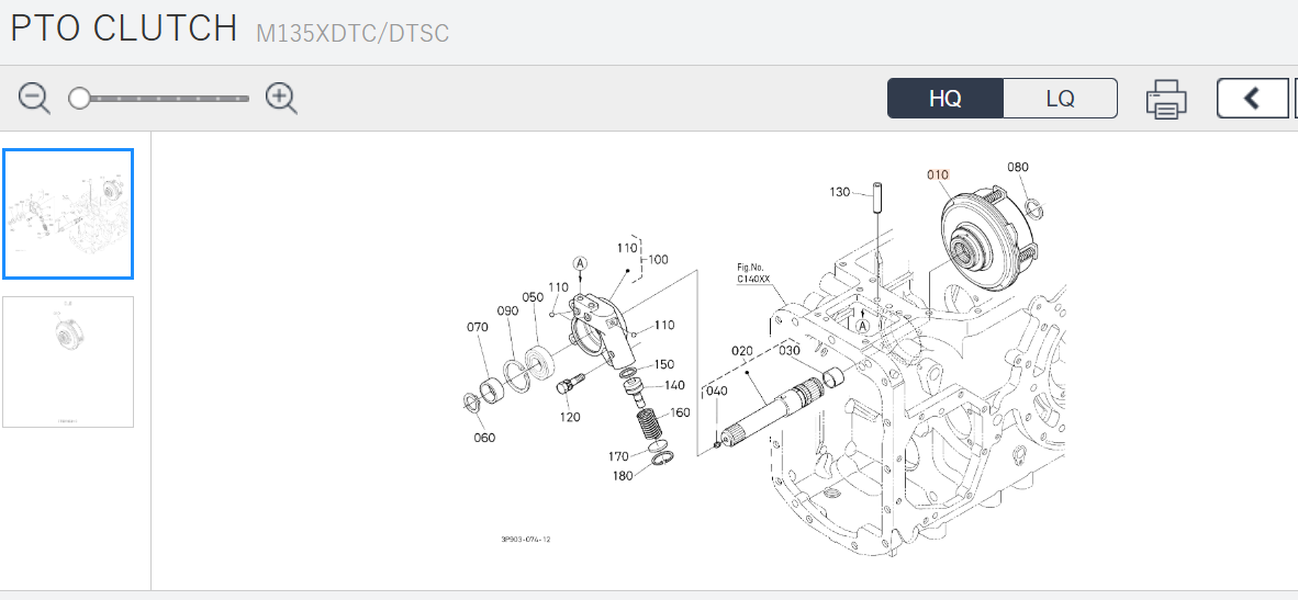

Hi All. I'm interested in buying a 2010 M135X which looks really nice and clean with only 4xxx hours but it has a weak PTO clutch. I can't find anything out when searching online about how big of a project this might be. Does anyone have any experience replacing one of these or have ideas what might be causing it other than a worn out clutch?
32,912
8,376
The WSM is going to be your friend on troubleshooting this setup.
The clutch is buried in there pretty well.

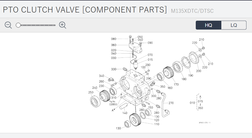

But it has a very complicated clutch valve and that is external.
