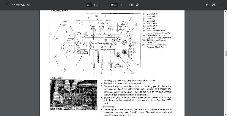

This is a picture of the pressure switches. #1 will be the one that has failed if one has failed. you can swap it with any of the other ones to see if the problem goes to another gear . If it don't change then the switches are OK and you will have to split the tractor and repair the clutch pack.

Many thanks. I can do that. So there are 2 pressure switches I should interchange. If one is bad, the problem should reverse the upper and lower end of the pattern. Is that correct? Besides being under my feet,how else can I identify them. Your help is appreciated.
